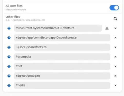

I installed it but I don’t know if it allows access to my nix store. Can you check from the screencapture, if it does allow? If not how can I allow that?
Doesn’t look like it was allowed.
Even though you allow read only access to a location that might have symlinks to fints, you simply do not allow the final location of the links to be read.

I tried add ~/.local/share/fonts/system-fonts:ro manually through flatseal but it didn’t help.
Can you try adding the directory he mentioned?
I didn’t understand. Which directory did he mention? /nix/store/?
The “nix store”, which is /nix/store indeed.
Alright, I did add it but the issue is still not fixed. I also did a system restart afterwards.
