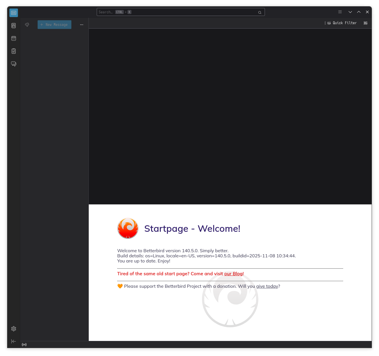

Here is an updated Betterbird package built from source based on Thunderbird 140 ESR, if anyone is interested.
It includes globamenu support.
I’m starting to understand why the original maintainer gave up on this, every build takes ~25 minutes to complete, so it takes a quite while to fix and test any error. :smile:
