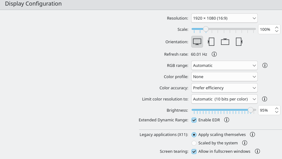

My external monitor is not show by xrandr nor the Display configuration of KDE and gets no signal from my Laptop.

  • The display configuration in the KDE settings does not show the rectangle where you can arrange your monitors:
    Screenshot_Display_configuration

Addition:
  • A monitor connected with HDMI - HDMI - cable was properly recognized and usable (unfortunately it’s not the hardware I have at home).
  • A Fedora 40 Xfce Live Stick System does not recognize the monitor at the HDMI - DisplayPort cable either.
    Addition II:
  • The HDMI - DisplayPort cable was working with my other NixOS Computer as a DisplayPort - HDMI cable (DisplayPort at the DockingStation, HDMI at another TV monitor). According to a comment to a question on askubuntu, this is the issue for the HDMI-DisplayPort setup but it leaves the Thunderbolt-VGA-VGA issue still open:
Are you aware that HDMI/Displayport adaptors/cables are directional (well, all the ones I know about anyway). They only work when plugged in the right way around. So you can buy either a HDMI to DP OR a DP to HDMI adaptor. You need of course HDMI to DP (HDMI source outputting to a DP monitor).
