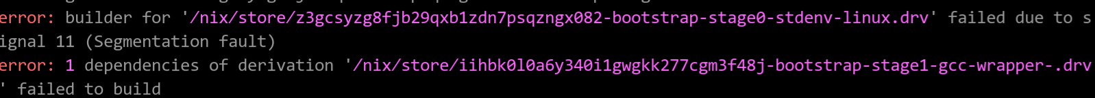

failed to build bootstrap-stage0-stdenv-linux.drv due to signal 11 (Segmentation fault)。
I confirm this will happen on arrch64 platform,but without problem on x86_64 platform.

I assume your system is using 64k page. The issue is related to
patchelf, for some reason, in bootstrap-tools, it seems to have been
compiled with 4k page size.
