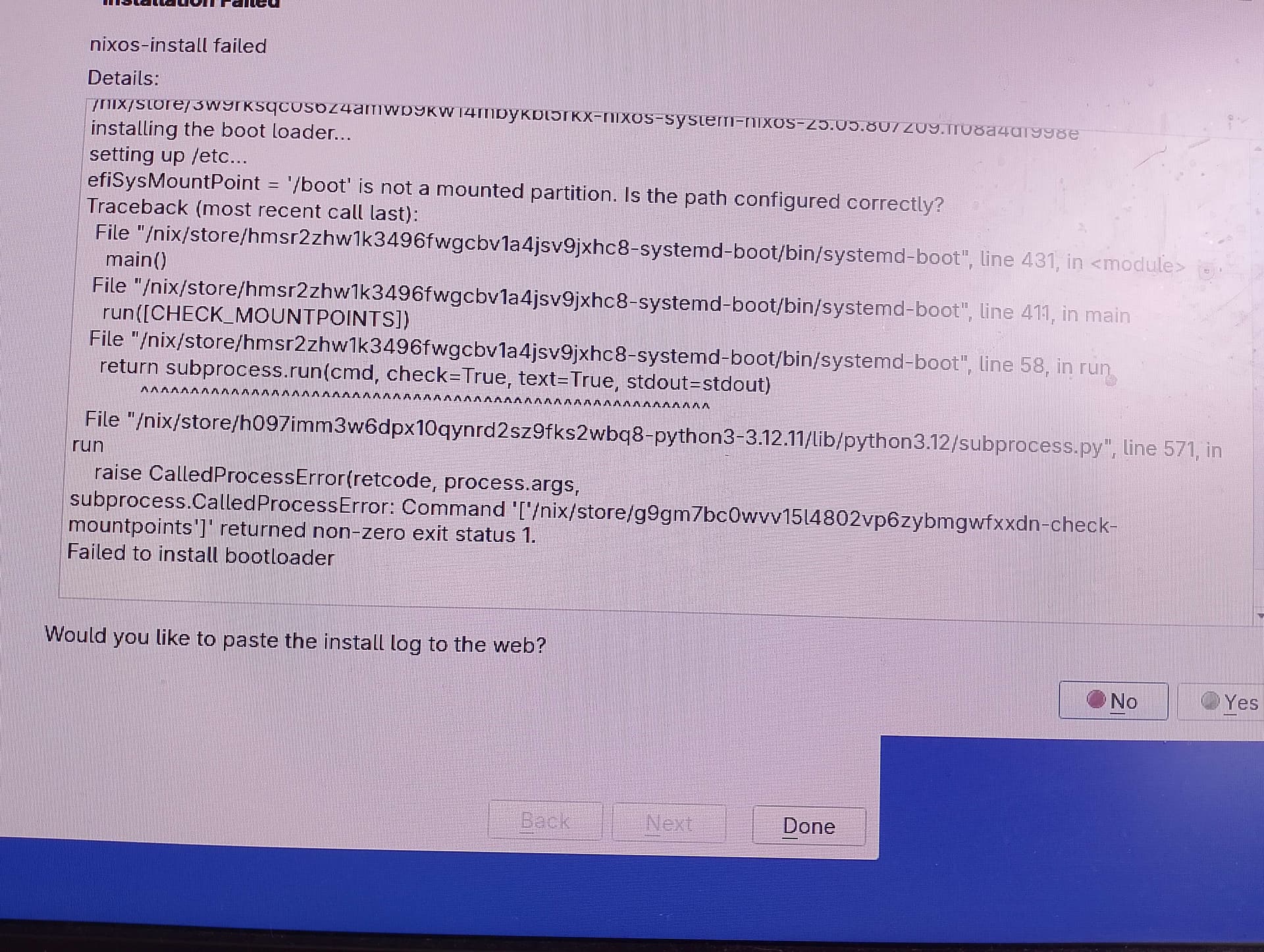

I am new at NixOs and try to made dual boot with Arch (My old system).
I use Ventoy to made Flash with NixOs (Graphical Installation) and try to use it, but when i setup everything and installation going to end, it throw me ‘Failed to isntall bootLoader’.
I never do something like this before, so i am totally unsure what i should do.
I try to find other topics about this, but didn’t found any solution for me.

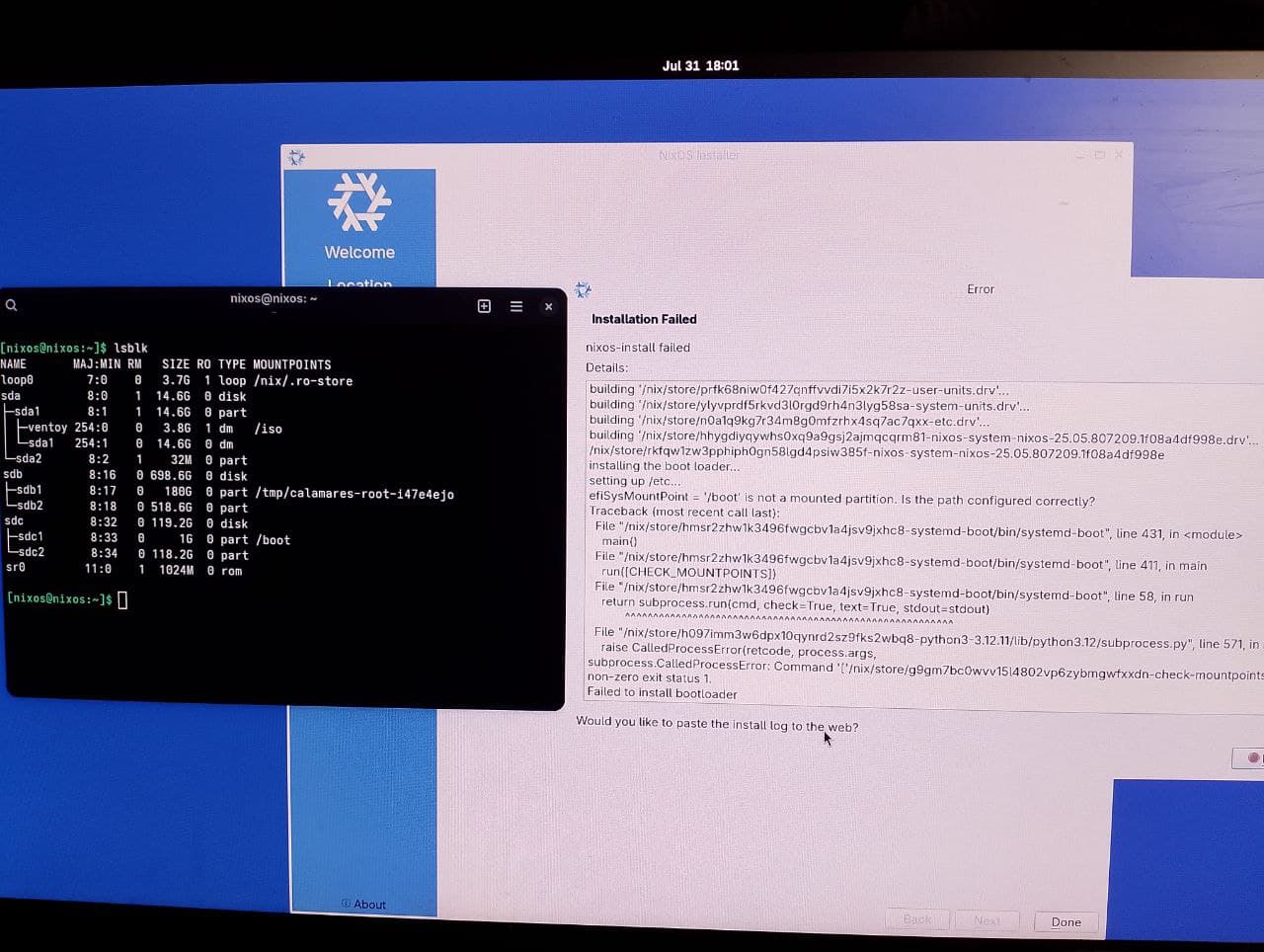

You forgot to mount the /boot
partition.
Can you check the mount
s to see if /boot
is successfully mounted?
Also, did you check if
boot.loader.grub.useOSProber = true
Is set? (if you are using grub)
Otherwise, you won’t be dual booting because only “nixos” will be shown then.

Probably NixOS is in an unbootable state because NixOS itself didn’t generate his boot file.
Since I am not using grub myself, I would suggest consider a reinstallation and make sure that /boot
is now mounted using the mount
-Command.
/boot
wasn’t mounted, so i mount it, but it didn’t help.
After trying to install it not in UEFI it installed and work, but looks like new generations builded with nixos-rebuild command didn’t apear in GRUB.
