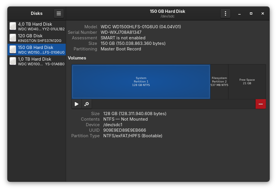

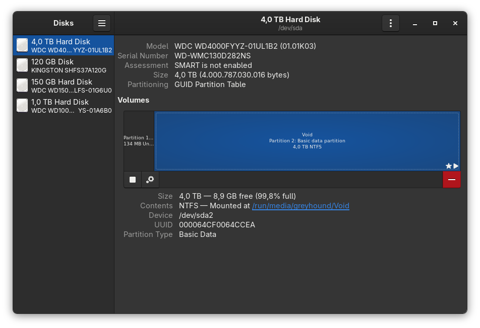

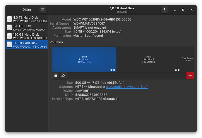

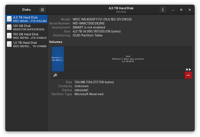

May I see the partitioning of /dev/sda please?
Yes, of course.

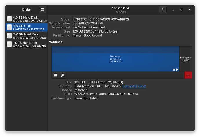

Mind you, sda is just for data storage. NixOS is on sdb and Windows is on sdc.
I’m not sure why sda using GPT is suddenly an issue after so many months.
sda
sdb
sdc
sdd
GRUB needs space to install the stage 1.5 bootloader on BIOS devices. On MBR partitioned disks it uses the first 1MB of the disk as this is typically left unallocated. On GPT partitioned disks, part of the first 1MB is used for partition tables so GRUB needs another space allocated for it (BIOS Boot Partition).
What might have happened is that the device order changed so e.g. sdb (an MBR disk) used to be sda, you might want to use /dev/disk/by-id to specify a stable identifier for the disk you want to install GRUB to.

/dev/disk/by-uuid/f24c622b-bc84-410d-9dba-4ce8a03a947a is the identifier for sdb, the NixOS drive.
  1. While f24c622b-bc84-410d-9dba-4ce8a03a947a is the UUID for your NixOS partition, it’s sdb1 not sdc.
  2. /dev/disk/by-uuid/f24c622b-bc84-410d-9dba-4ce8a03a947a refers to a partition not a disk, GRUB on BIOS needs to be able to write to the first block of the disk.
/dev/disk/by-id appears to be able to refer to a disk, you can use ls -l /dev/disk/by-id to find an id refering to sdb.

I checked the disks again, out of curiosity, and the letters seem to have swapped again between reboots. The device that was previously sda is now sdd, and the Windows device is now sda, while it was previously sdc. The NixOS device went from sdb to sdc, and the final disk went from sdd to sdb.
Good thing IDs don’t change like this.
