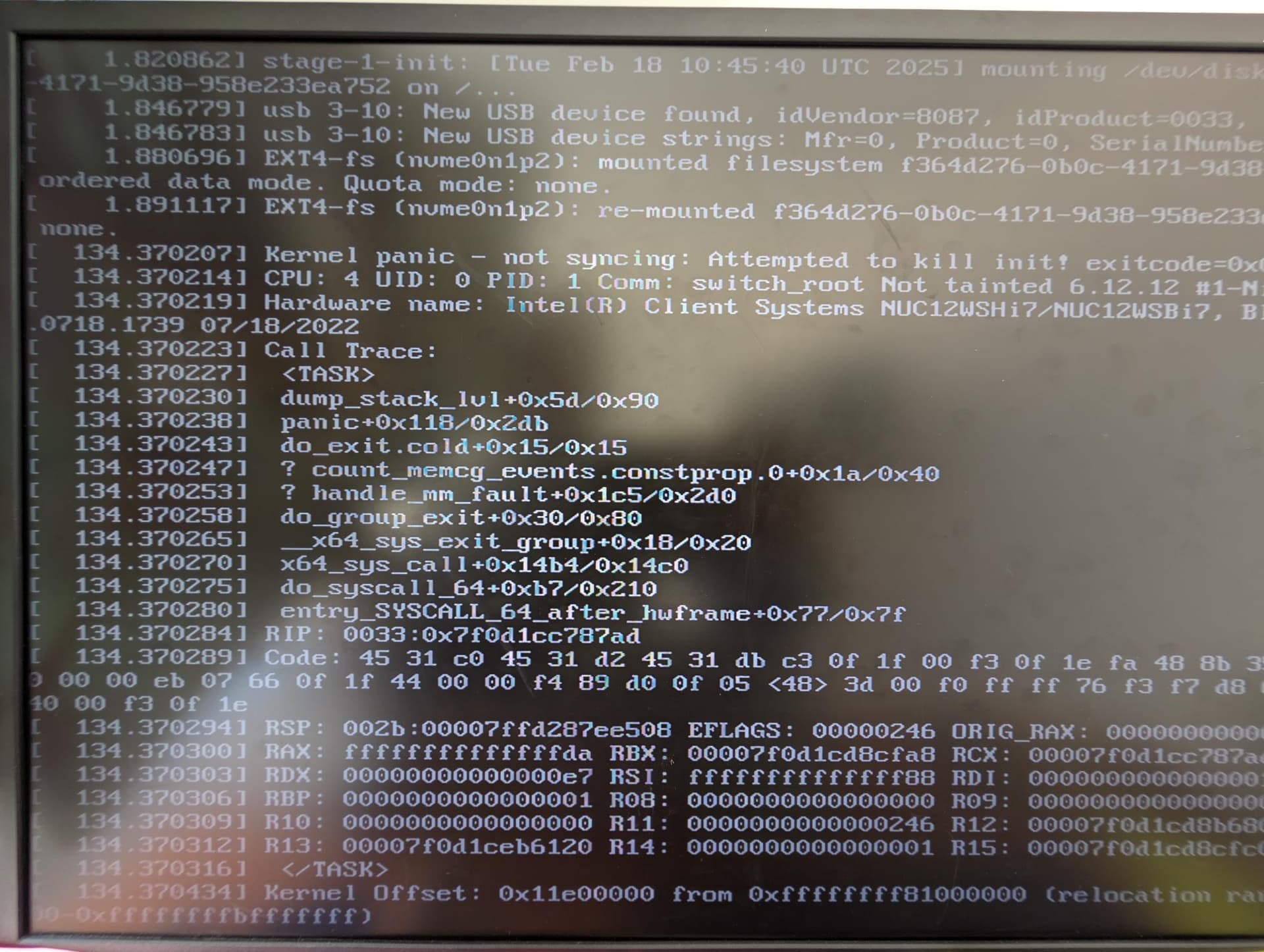

I also tried to rollback to a previous generation by pressing Esc during the reboot and selecting an older generation, but it gets stuck at the following screen:
From here, pressing either * or r gives me this:

Hi @Postboote, Thanks for your kind help. I was stuck because I did not know how to enter tty! Indeed entering CTRL+ALT+5 at the screen that was stuck worked and from there I could further troubleshoot.
In fact, the reason seemed something very silly. Pinchflat had consumed all the disk space. So once I opened some space, the Display Manager started correctly with no problem.
