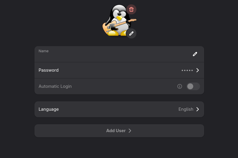

I’ve recently got a Dell Vostro 15 7510 and set it up with NixOS. It has a fingerprint reader which is working fine, except for one thing. I don’t have any options to manage it in Gnome. I can only enroll fingerprints with fprintd-enroll. This isn’t a huge issue, but I feel like I’m missing some functionality with other software. For, example, whenever I try to enable fingerprint authentication in Bitwarden, it simply doesn’t work.

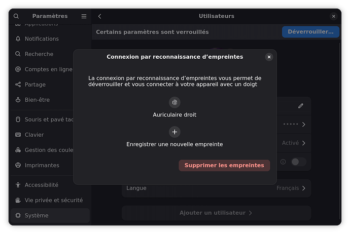

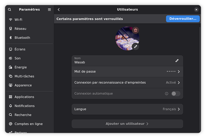

Hi again !
I’m noticing that I indeed wrote this message but forgot to send it since I was still trying to figure out the exact steps :
Okay, so after trying to clean up my configuration and the things I blindly added, it wasn’t working anymore.
So here are exactly what made it work for me besides enabling fprintd.
  • adding my user to the input group through users.users.wasab.extraGroups
  • adding the following line to the config :
    services.desktopManager.gnome.sessionPath = [ pkgs.gdm ];
After logging out and logging back in it should work.

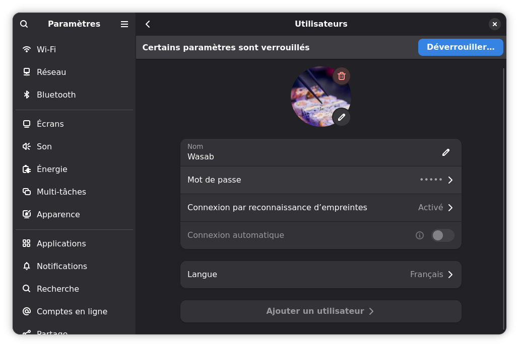

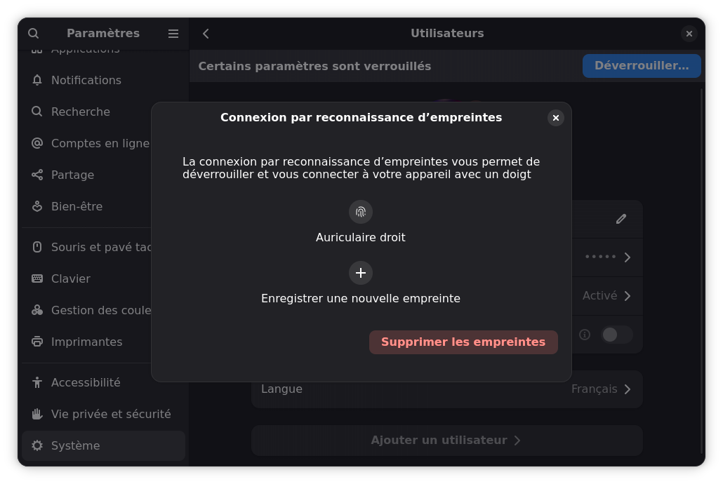

Thank you so much! I got curious and put NixOS back on the laptop in question temporarily and tried fiddling with it again. I really didn’t want to leave this one hanging in case somebody else came along with the question.
You are spot on with your config. Along with adding services.fprintd.enable = true;, I added my user to the input group and added services.desktopManager.gnome.sessionPath = [ pkgs.gdm ]; to my config.
I did not need the other two services.fprintd.tod options, but depending on the fingerprint reader, I suppose that might be necessary for others.
Thank you again for your assistance. I was really glad to see those options pop up in my Gnome user settings.
