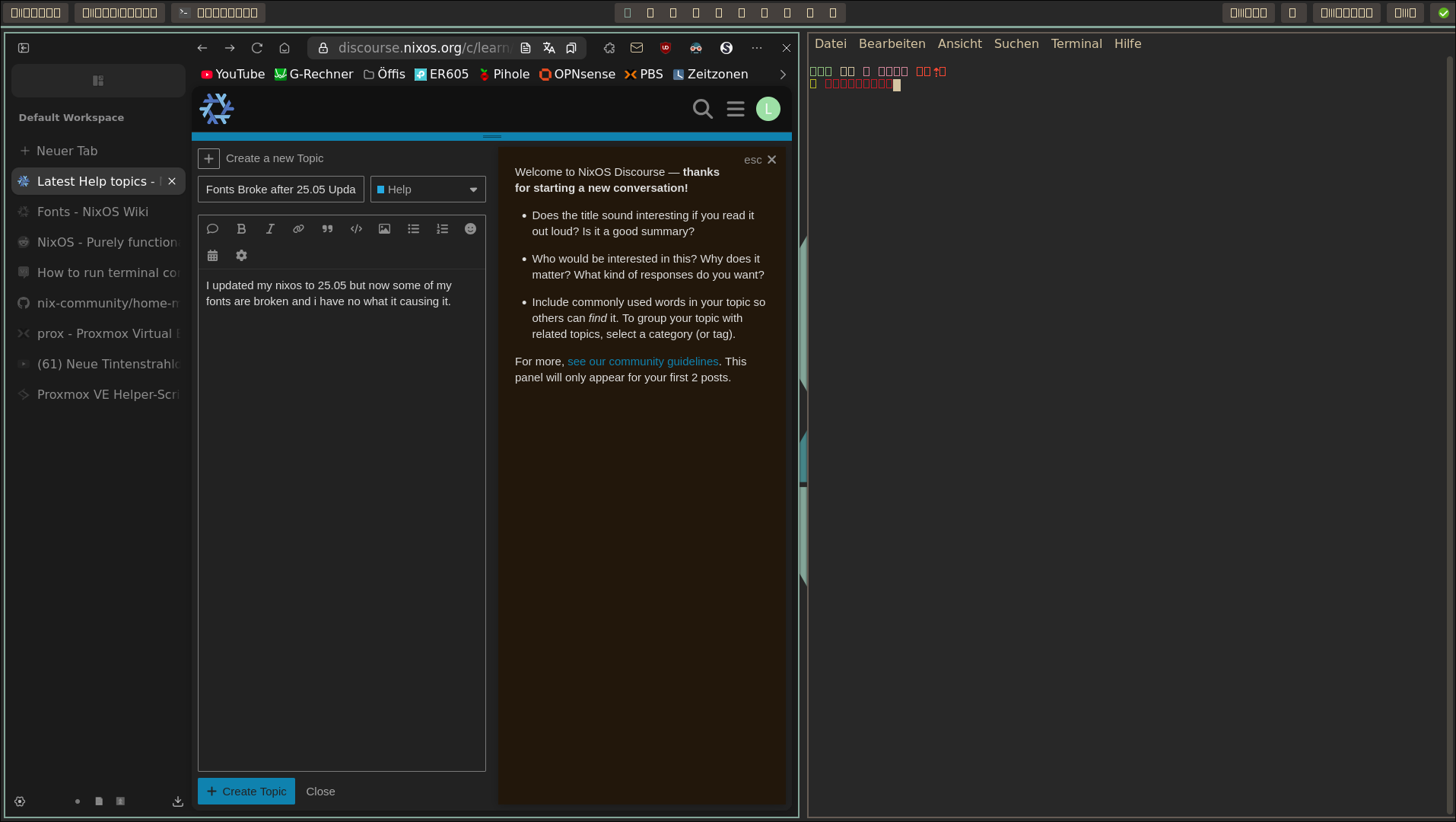

I updated my nixos to 25.05 but now some of my fonts are broken and i have no what it causing it.

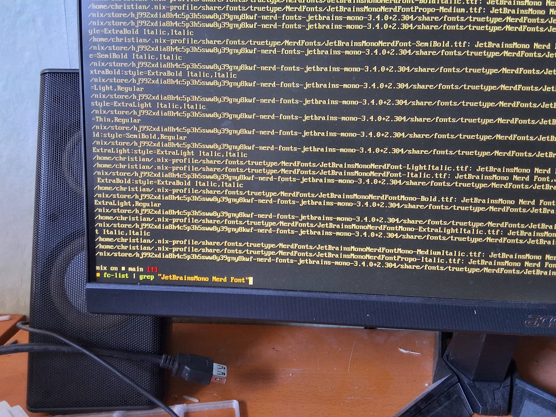

Already did, JetBrainsMono Nerd Font is listed there. Cant paste output as i did it with Strg+ALT+F2 as my terminal broke with the update.

Currently use an alternative terminal with working fonts:
Opening with nvim over neovide. Running :terminal
