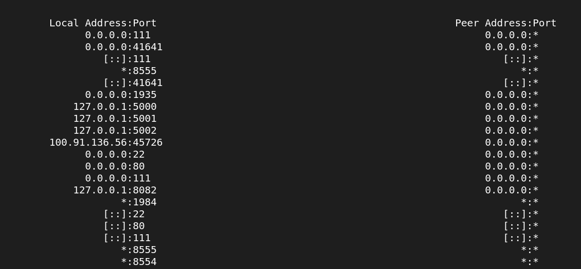

I'm trying to add the Frigate integration in HA. They are hosted on different machines: HA (192.168.2.10) and Frigate on (192.168.20.2). I've followed the instruction in Frigate docs, and it did add it to HA. However, it only adds the sensors, configuration and diagnostic entities. And all of those do seem to work. However. it doesn't add the media player with the camera feed. I also can't play the recordings from the media browser in HA (although I do see the files).
In HA, I've tried:
- enabling/disabling "Use Frigate-native WebRTC support"
- setting the RTSP URL template to: "rtsp://192.168.20.2:8554/{{ name|lower }}"
- setting the RTSP URL template to: "rtsp://myuser:mypassword@192.168.20.2:8554/{{ name|lower }}"
I reloaded the integration after each of those changes, but it didn't make any difference.
There is obviously something off with my config, but I really don't know what to try anymore. Btw. the reason I'm configuring the camera the way I do in Frigate, is beacause it's a Reolink camera, and I was following these official docs: https://docs.frigate.video/configuration/camera_specific/#reolink-cameras. This was the only config that made it stream fluently in Frigate, everything else was stuttering or failing to play at all on an Android phone.
Maybe it's not config, but a networking problem, but somehow I doubt that, since it's detecting all the sensors and everything else correctly. Even the snapshots of the last detected objects are showing in sensors. Also, I still have the HA Reolink integration running, and it is streaming fine. If it's relevant, I'm using "network_mode: host" in Frigate docker config.
Also, I can play the stream in VLC, through rtsp://192.168.20.2:8554/front_yard_camera
Similarily, if I go to http://192.168.20.2:1984, I can see (and play) the stream there:
Can someone please help me get this working?
