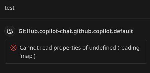

But vscode immediately throws this error: “You’re running in a KDE environment but the OS keyring is not available for encryption. Ensure you have kwallet running.” The Github Copilot chat window is available anyway, but just reports strange errors if used, like “Cannot read properties of undefined (reading ‘map’)”.
I tried to activate kwallet (without fully knowing what it is), and then the OS-Keyring error does not come up anymore, but the errors in the chat window stay the same.

I also updated my nixos installation in hopes that would fix things, but it didn’t (the error in the chat window just changed to what it is now. It was similar garbage before). I did the update like this:

I have the same issue with Github copilot giving the error "Cannot read properties of undefined (reading ‘map’), and I have not found a solution.
