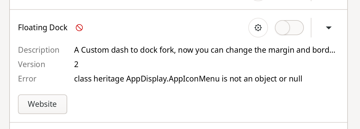

Updated nix channel again today and now installs the correct one.
How now it doesn’t load with class heritage AppDisplay.AppIconMenu is not an object or null error:
(The same error btw when I tried to install directly from FF extension mgr)
Any ideas?
That extension does not seem to support GNOME 41, see
Gnome 41: Change out AppIconMenu for AppMenu by dahjah · Pull Request #6 · fer-moreira/floating-dock · GitHub.
Righto! Hopefully they will address it soon.
Many thanks!
