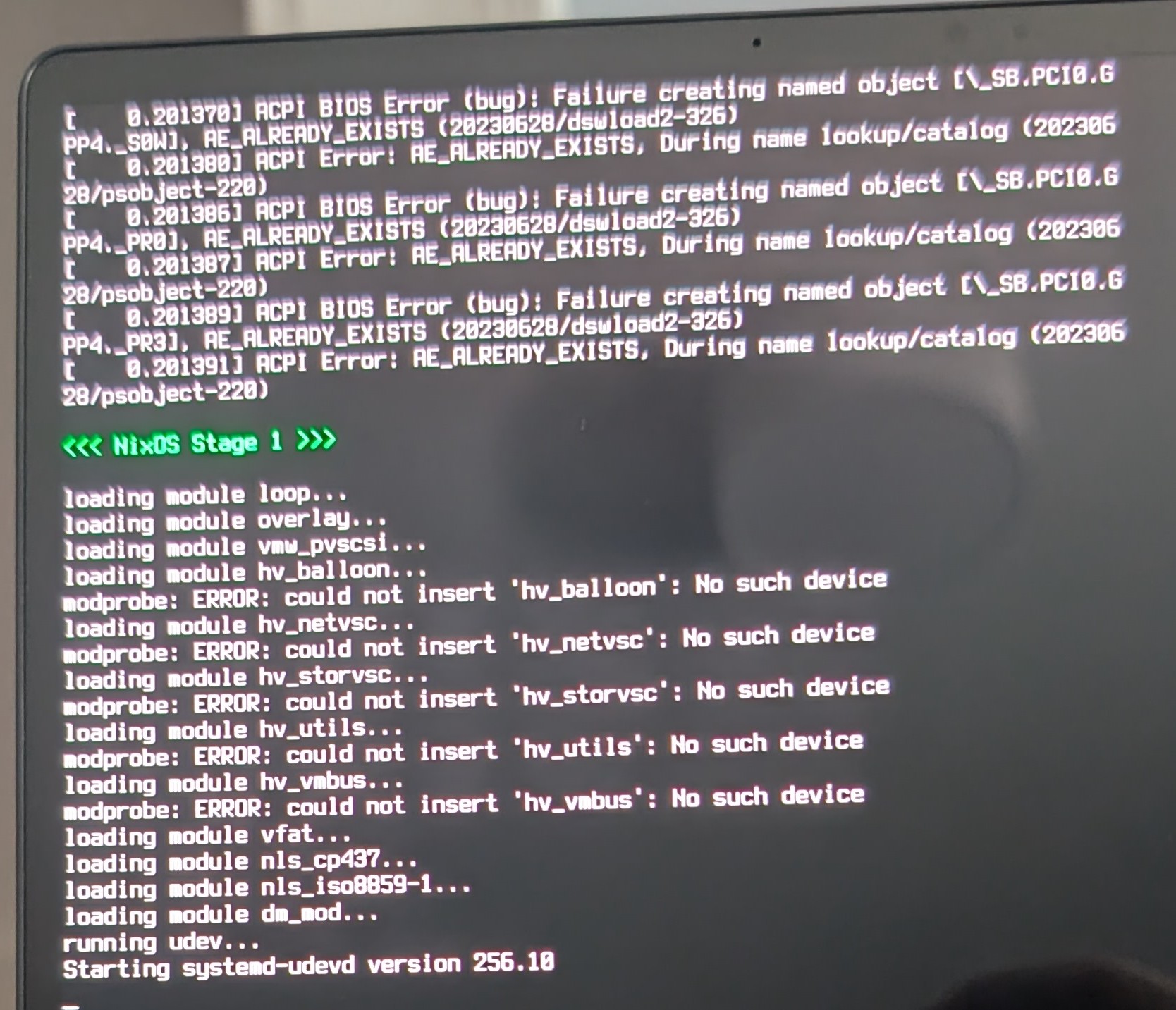

I got a new Asus Proart X13 and downloaded the latest ISO nixos-gnome-24.11.716947.26d499fc9f1d-x86_64-linux.iso.crdownload. When I boot from USB it says <<< NixOS Stage 1 >>> and then when it gets to “Starting systemd-udev version 256.10” it hangs.
The laptop has one of the newer Ryzen “AI 9” HX 370 CPUs so I suspect it needs a relatively new kernel. Any suggestions?

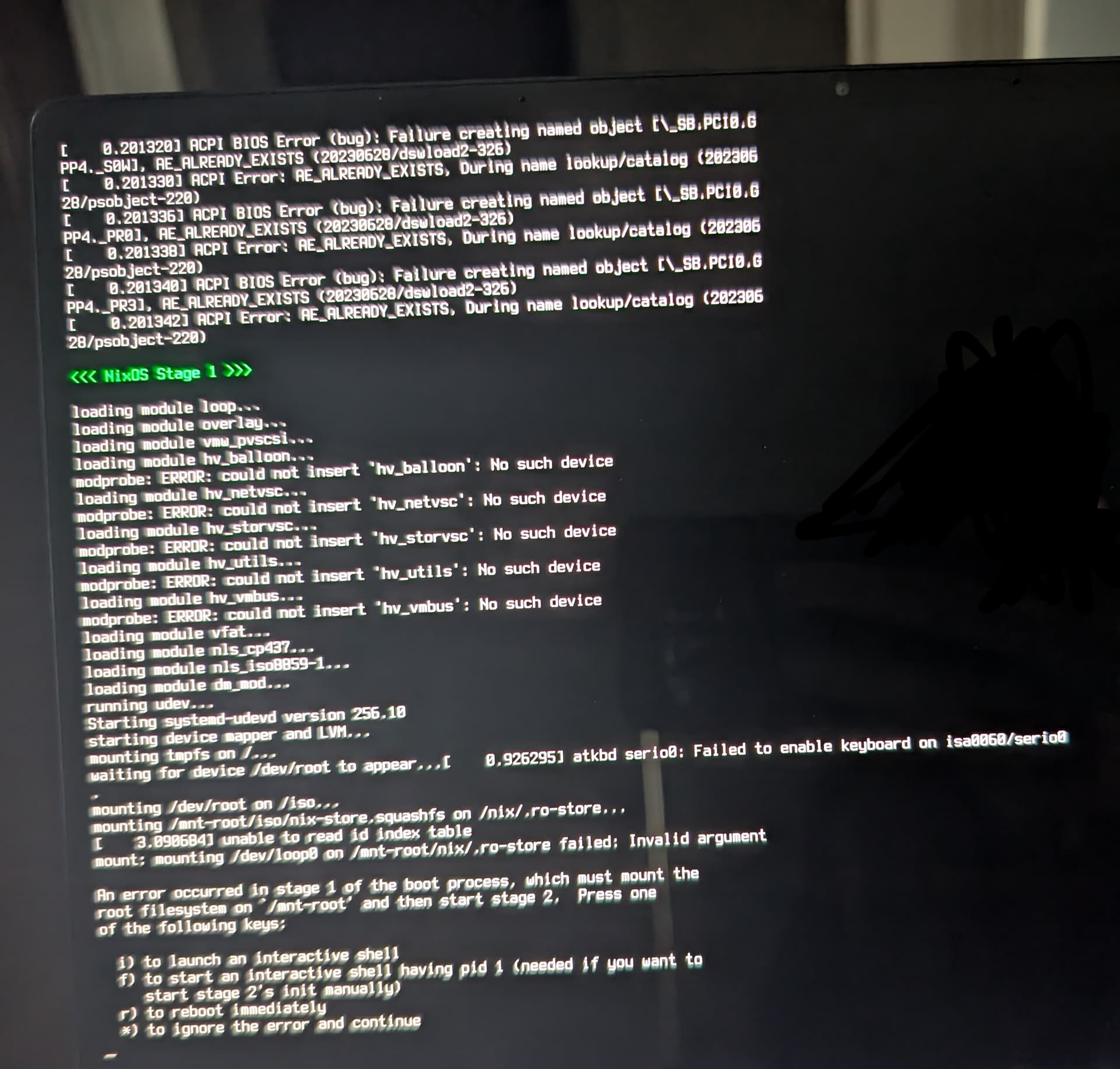

Hi, I’m the ISO maintainer for NixOS and I would still like to figure out what was going wrong with the graphical ISO. Can you try booting it again, but at the boot menu, press the e key and add plymouth.enable=0 to the kernel params?
Sure, I put it after the loglevel setting since that looked like the right general area, got this
That’s really odd. What did you use to write the ISO to the USB drive?
I just did sudo cp nixos-gnome-24.11.716947.26d499fc9f1d-x86_64-linux.iso.crdownload /dev/sdb, then ejected in thunar to be sure it was fully written. I just repeated it to make sure it wasn’t a fluke.
Ok yea that should be fine. I guess the next things to check would be A) that your download isn’t corrupted, i.e. that the sha256 of the ISO file matches the one on Download | Nix & NixOS and B) You can press i at that error screen to enter a shell and run dmesg to see if the kernel logged an error about the squashfs.

Oops, yes @eblechschmidt is right, for my original plymouth.enable=0 tests I was copying an incomplete image! I just used tab completion and didn’t inspect the full name. Maybe there should be some integrity check at the start of install so users don’t waste maintainer time with this?
Okay so with the correct full image, I can reproduce my original issue if I don’t set plymouth.enable=0, where it gets stuck on the Starting systemd step. When I do set it, I successfully get into the graphical installer! What would be the next step to debug why, assuming you still want to know why this setting was necessary?
It’s really weird that having plymouth enabled causes it to not reach the GUI… What if you hit the escape key after the screen seems to hang? That causes plymouth to show a log instead of the boot splash.
