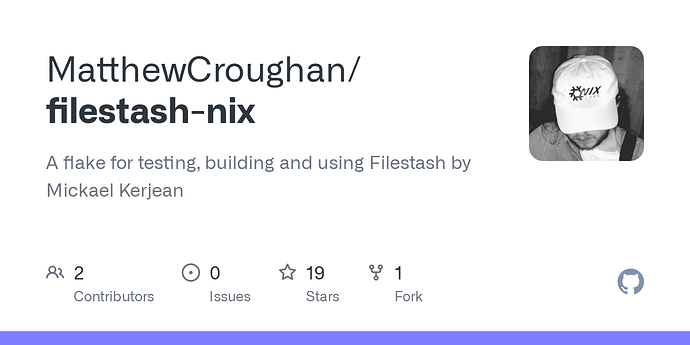

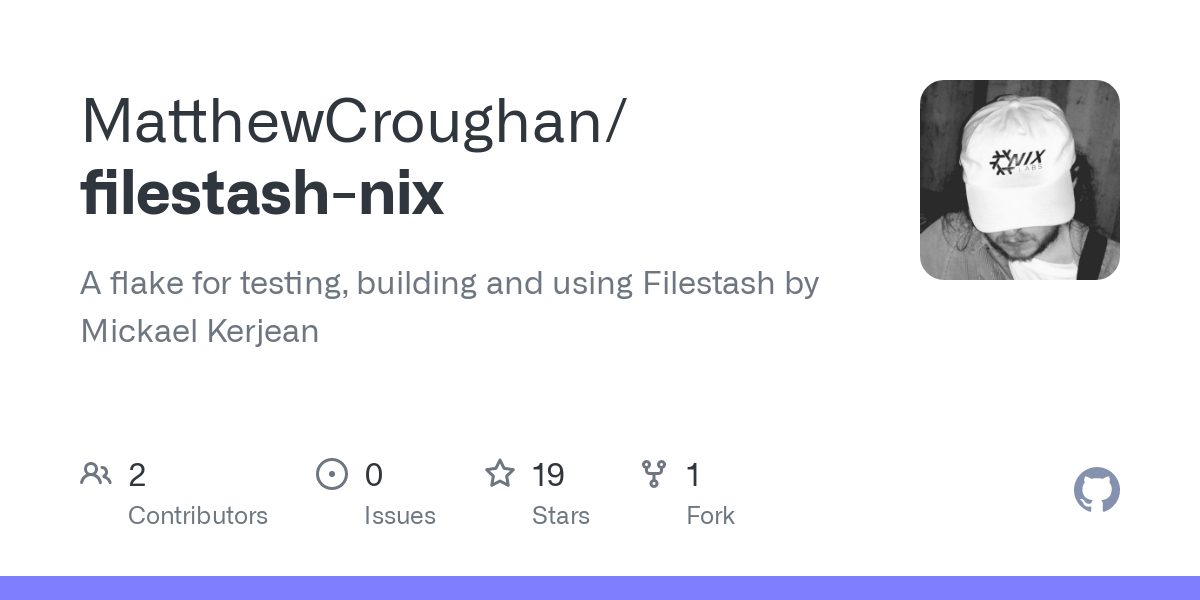

@nurelin @pinpox I figured everything out and created a high quality flake with a NixOS Module, VM Test and CI here
I also created a PR here that would have it added to NixOS Search? if it were merged.
https://github.com/NixOS/nixos-search/pull/547
