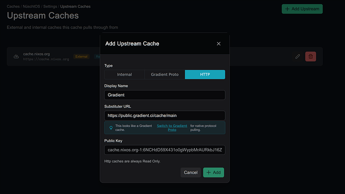

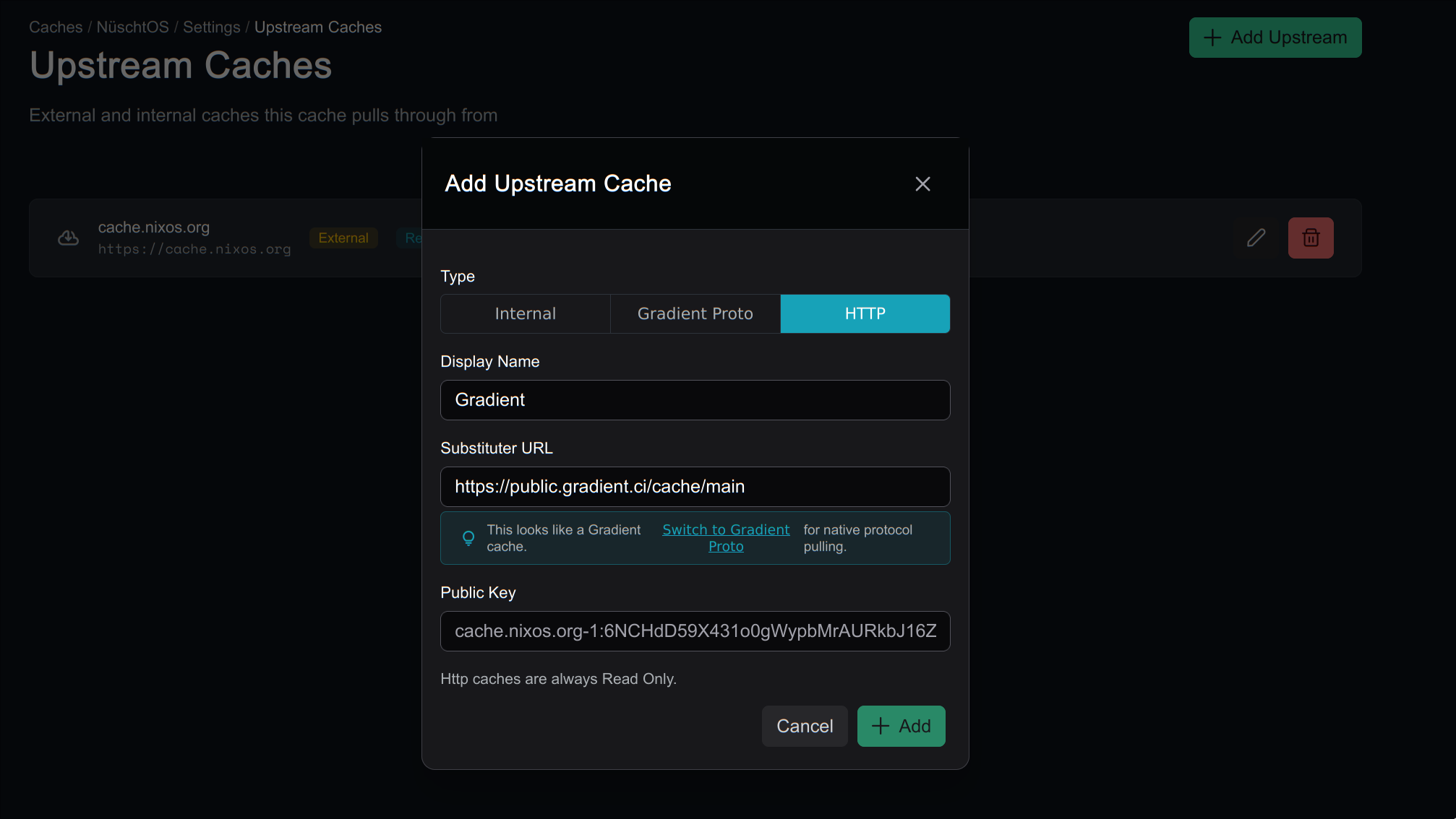

This seems pretty great - what would a comparison be with something like the Nix buildbot integration? And how would it play with an existing internal binary cache such as straight S3 or a niks3 cache?
There are Worlds between Bulidbot Nix and Gradient, so I can’t really compare them in General (It wouldn’t make any sense). But speaking about the Forge Integration alone Gradient might be better Configuration wise, but also has a steeper learning curve in comparison to Buildbot Nix. You will have to take some more time when setting up Gradient the first time. While also Buildbot Nix has a more refined Integration (e.g. it shows some formatted tables directly in GitHub). You can just take a look at both GH Repos, open a random PR, and compare each applications integration yourself. It’s not that much of a difference overall.
Gradient is not compatible with other binary Caches. The main reason for this decision is maintainability. Gradient will host a binary Cache and if you want to use the Gradient S3 backend you’ll be able to configure a S3 in Gradient. The Gradient Cache itself should be performant, has the ability to be only used as private cache (only allows substitution if clients provide Credentials) and does rate limiting and garbage collection. If you have a external binary cache you can configure it as a substituter for Gradient.
If your external Binary Cache supports the Gradient Proto, things changes, then Gradient will also be able to write to the external Binary Cache. Gradient will automatically detect if the cache speaks Gradient Proto:

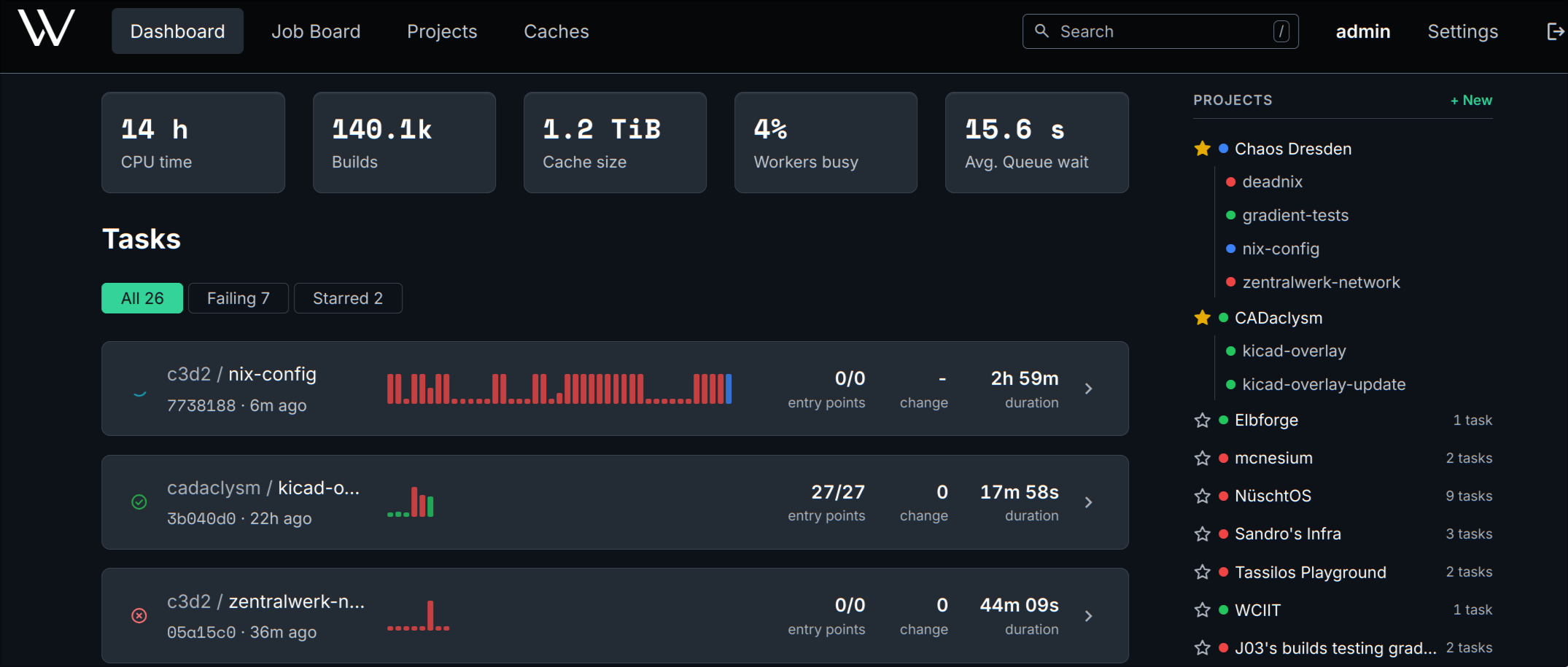

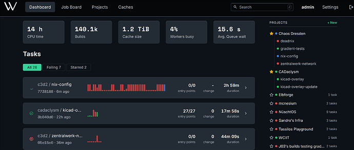

Long time no see. Gradient v1.4.0 is live.
And as your average AI Lab CEO would say: “This is our most capable release yet.”
While AGI is still miles away, fast Nix builds aren’t. Here is what’s new in v1.4.0:
  • Multi-Node Evaluation: We’ve taken a massive step forward by enabling multiple workers to evaluate across the same dependency tree simultaneously. Multi-Node same Flake Evaluation is on the Roadmap for v1.5.0.
  • Smarter Dependency Graphing: A long-requested feature is finally here. Gradient now automatically skips build-time dependencies that aren’t strictly required, cutting down cache and build overhead.
  • Prioritizing Score: Super Users now can prioritize certain builds or evaluations to move faster ahead in build queue.
  • New Dashboard: A fully overhauled, refined Dashboard UI to monitor your current Projects.
