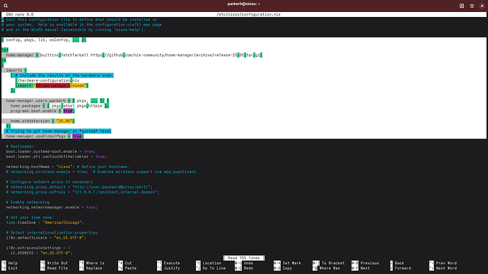

After finishing the installation process (and used sudo nixos-rebuild switch (which built successfully)) according to NixOS module, I went to use nano ~/.config/home-manager/home.nix (according to Using Home Manager) and it wasn’t a pre-existing file.
I have provided the Home-Manager section of configuration.nix in the screenshot provided.
Assistance would be greatly appreciated <3

~/.config/home-manager/home.nix is the file used for standalone home-manager configurations. If you use home-manager on NixOS you should never create it.
Instead, the home-manager module entrypoint goes directly into the home-manager.users.<username> option. It however contains the exact same contents as the home.nix file would with a standalone setup.
The docs never really explain the difference between a home-manager or NixOS setup, and interleave the setup for the two different systems, and then only have a section explaining how to use the standalone configuration, never properly distinguishing the two. It’s not surprising that you would be confused.
If you want to, you can change your configuration to:
# /etc/nixos/configuration.nix
{ config, pkgs, lib, osConfig ...}: {
  # <snip>
  home-manager.users.parkerh = import ./home.nix;
  # <snap>
# /etc/nixos/home.nix
{ pkgs, ... }: {
  home.packages = [ pkgs.atool pkgs.httpie ];
  programs.bash.enable = true;
  home.stateVersion = "25.05";
That way you still have a file called home.nix, which might be a bit less confusing than an inline module.
Also, while we’re at it, don’t use builtins.fetchTarball without a hash. This breaks reproducibility and makes it so nix will just magically download a new home-manager every two hours, and spend the time doing that too, which slows everything down.

“Also, while we’re at it, don’t use builtins.fetchTarball without a hash.”
Is this the correct syntax?
  home-manager = # builtins.fetchTarball https://github.com/nix-community/home-manager/archive/release-25.05.tar.gz;

Repeating what those docs say, but tailored to your current configuration and question, the syntax you’re looking for is:
  config,
  pkgs,
  lib,
  # I think you have to remove `osConfig`, it should only work in home.nix
  imports = [ <home-manager/nixos> ];
  # <snip>
This is similar to your variant, except that:
  • We removed the redundant call to import (the imports NixOS module feature does that for us)
  • We’ve replaced the variable substitution with a lookup on the NIX_PATH
This uses the angle bracket (<>) syntax to look up files in the NIX_PATH variable. By default the NIX_PATH includes the /nix/var/nix/profiles/per-user/root/channels file, which causes nix to look up files according to your root user’s channel configuration.
Of course, by default <home-manager> is not in your channel configuration; the default config only contains the <nixos> channel. See the home-manager documentation I linked earlier for how to add a home-manager channel.
