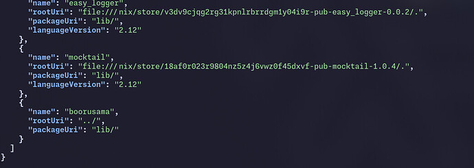

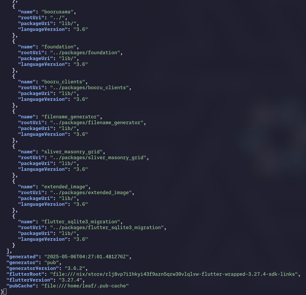

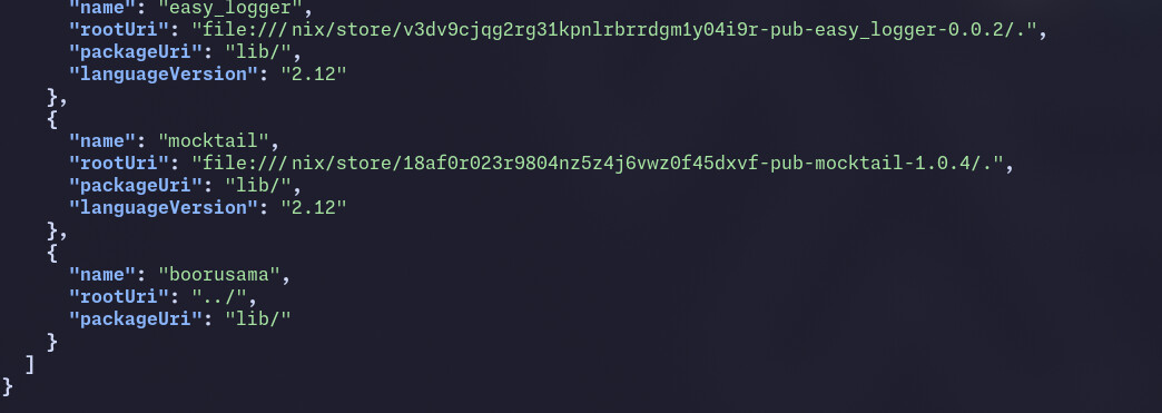

Previously, buildFlutterApplication worked fine. But now, the app depends on local packages in packages/. The .dart_tool/package_config.json generated by Nix excludes these local packages, unlike the one generated by flutter pub get due to which the build fails(using nix build .).
Here is the one generated by nix:
full file
and the one generated by pub:
full file
