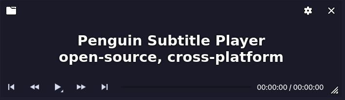

I have been trying to package the qt application Penguin Subtitle Player and I have solved some of the errors (I think) but I can’t seem to get the last step of installing the app.
