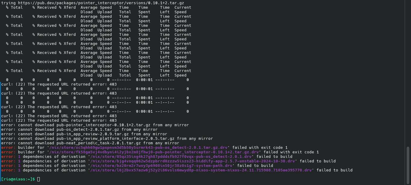

hello guys. hope u doing good. im a new nix user… i want to install this vpn:
how can i install it here?(can i install it with git clone and some other commands?how if yes?) i tried to installing here from (file configuration) but i got 403 instead. TSM for reading

Hi, like i said. Im facing with 403 error.
can you post the error you are getting
here it is
Most likely does a firewall in your network block that request. Have you enabled a vpn?

Well it’s an unfree app, which means hydra won’t build it for you, so you’d have to be able to download the relevant files from pub.dev yourself. I suggest not using any unfree flutter/dart app, since those apps will often come from pub.dev.
If you can find a distribution tarball somewhere else (maybe via a proxy specific to your country) you can add it to your store manually with nix-store --add.
Alternatively you could try to configure the underlying non-gui service, sing-box.

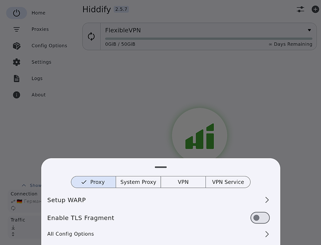

Make sure to choose Proxy in quick setting in the top right corner. I have a connection, but, sadly, it doesn’t open blocked sites
