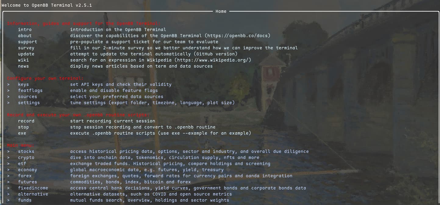

and upon executing the finale command, OpenBB works.
