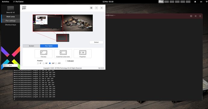

Okay,
I just built a separate boot profile to test the drivers. And they work perfectly, everything works as I remember, all the options are there, pen sensitivity, tilt functions hotkeying of buttons on both pen and tablet are working as intended!
Here are some screenshots!
