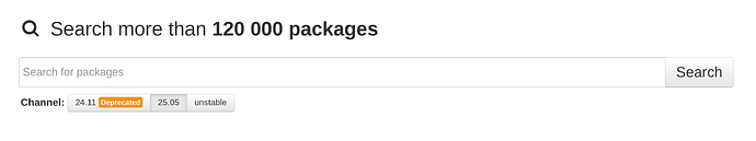

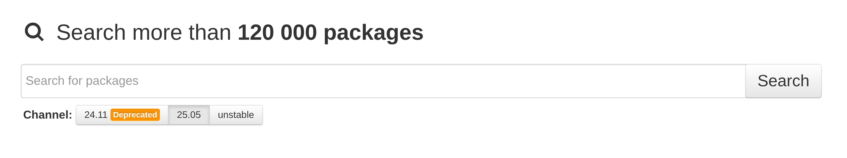

Personally, I frequently visit https://search.nixos.org/ where you can always see the current stable channel (the version nixpkgs repository and subsequently the version of NixOS).
