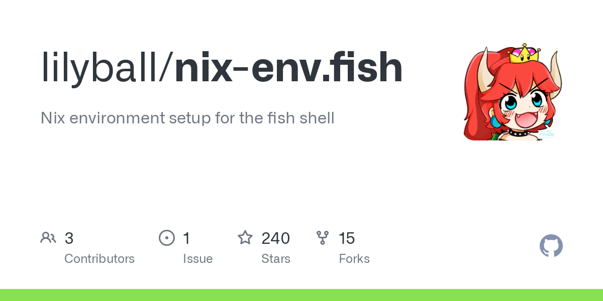

Thanks for the help guys, actually this fish plugin solved the problem.
