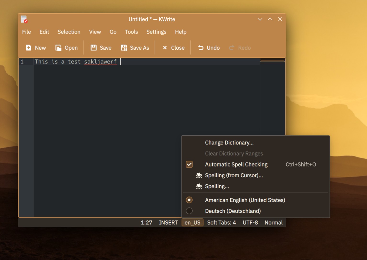

Don’t know. My actual dual language (de and en) aspell.nix config file which I include successfully on two machines on unstable is:
{ config, pkgs, ... }:
  # hunspell is not working: https://github.com/NixOS/nixpkgs/issues/26654
    aspell
    aspellDicts.de
    aspellDicts.en
    aspellDicts.en-computers
    aspellDicts.en-science
and it results in
Otherwise I don’t see any other spelling or plasma related changes in my config. It worked after I got and incorporated the hint by @nixinator from above.
