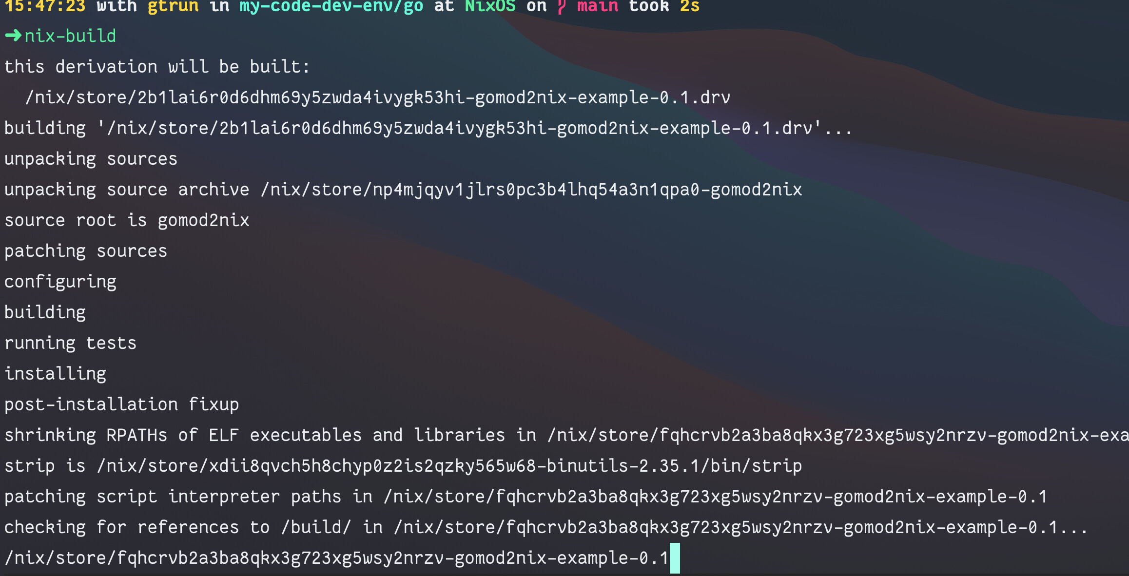

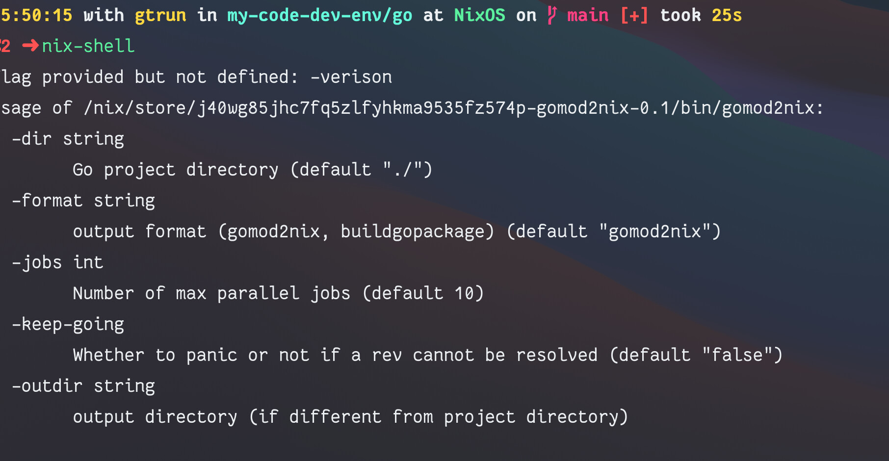

I wrote the flakeExample here GitHub - GTrunSec/nix-devops-cheatsheet: nix flake (preset) templates for the production of devops
let me test it.https://github.com/GTrunSec/Coding-Dev-Env-With-NixFlake/tree/main/gomod2nix
the way I do it currently is something like so:
outputs = { nixpkgs, ... }: {
  nixosConfigurations.myOsConfig = let
    pkgs = import nixpkgs { overlays = [ /*the overlay in question*/ ];
  nixpkgs.lib.nixosSystem {
    modules = [ { nixpkgs = { inherit pkgs; }; ];
This is the most similar example I needed to see, and from some reason it worked for me after I renamed the gomod2nix flake to gomod2nix-flake :slight_smile: Thanks!
I did a patch PR to fix that. Fix: flake overlay by GTrunSec · Pull Request #4 · nix-community/gomod2nix · GitHub :smile:
