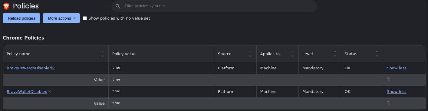

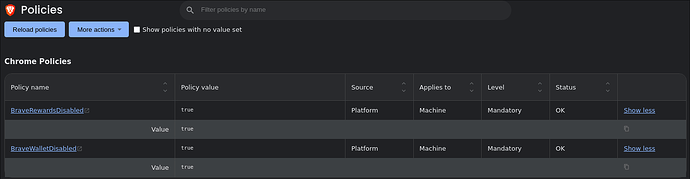

I created a policies.json file with the following:
  "BraveRewardsDisabled": true,
  "BraveWalletDisabled": true
Then in configuration.nix, I added:
  environment.etc."/brave/policies/managed/GroupPolicy.json".source = ./../home/apps/brave/policies.json;
You can use this method to set any of the policies Brave has listed (you may have to disable “Brave Shields” for the page to load, ironically). After switching to the new config and restarting your browser, you can go to your policy page to verify that the setting have taken correctly:
