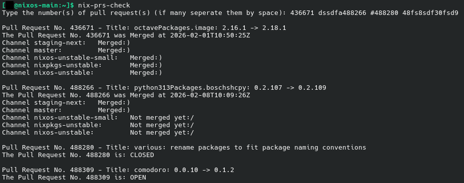

Demo
When running for example
$ nix-prs-check
With arguments: 436671 dssdfa488266 #488280 48fs8sdf30fsd9
I get this:
These pull requests currently on github:
  • 436671 - merged
  • 488266 - freshly merged
  • 488280 - closed
  • 488309 - open
