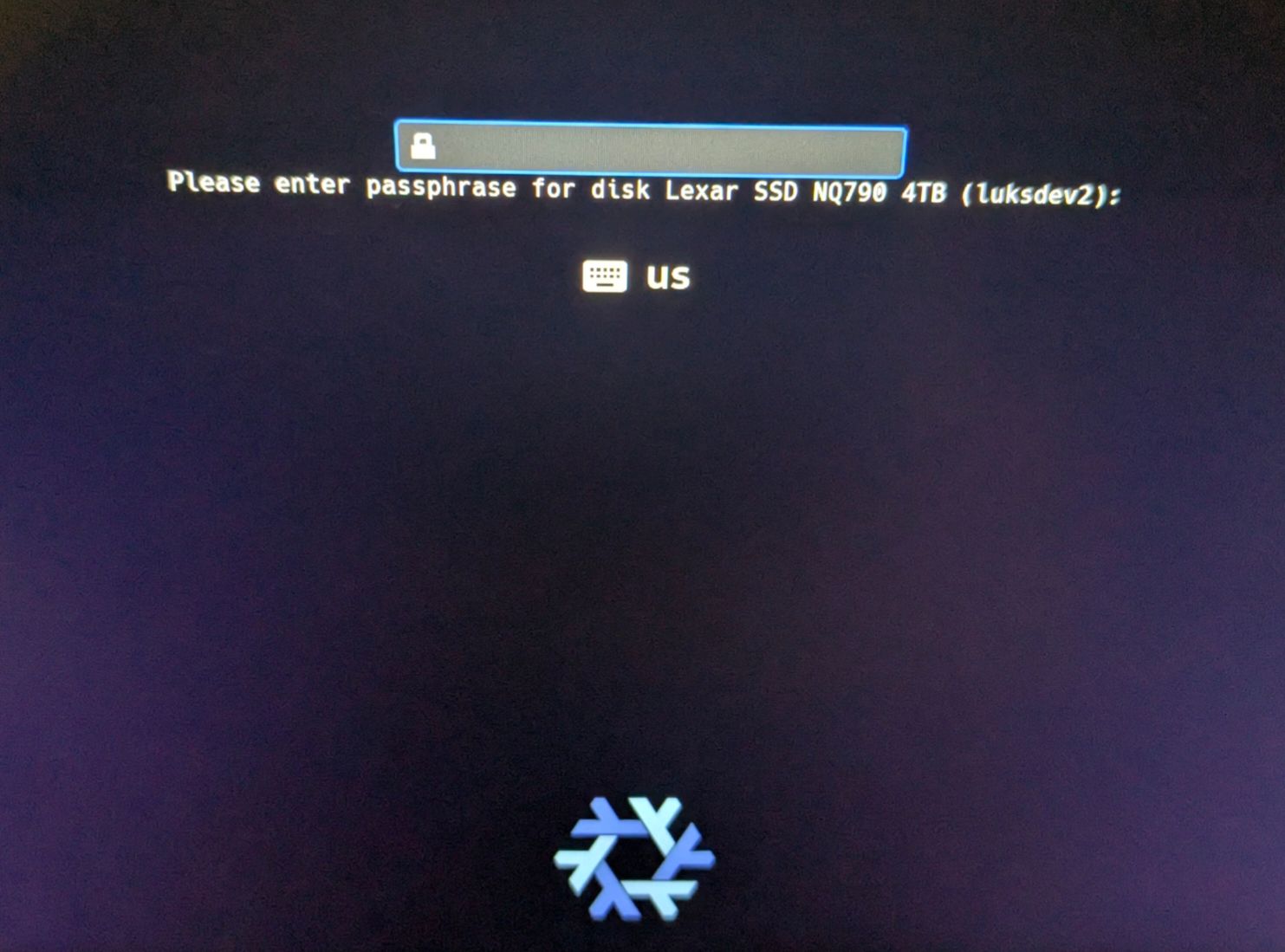

Linux systems show a lot of useful info when booting. On NixOS this is the default. The LUKS password entry finishes “Stage 1”, in “Stage 2” the unlocked system is booted.
All of this is shown in text only, which works fine, is efficient and simple, but might not suit your taste.
Fedora and other distributions primarily show a graphical boot screen, only when pressing Esc you see the text output.
We can achieve the same with a small config.

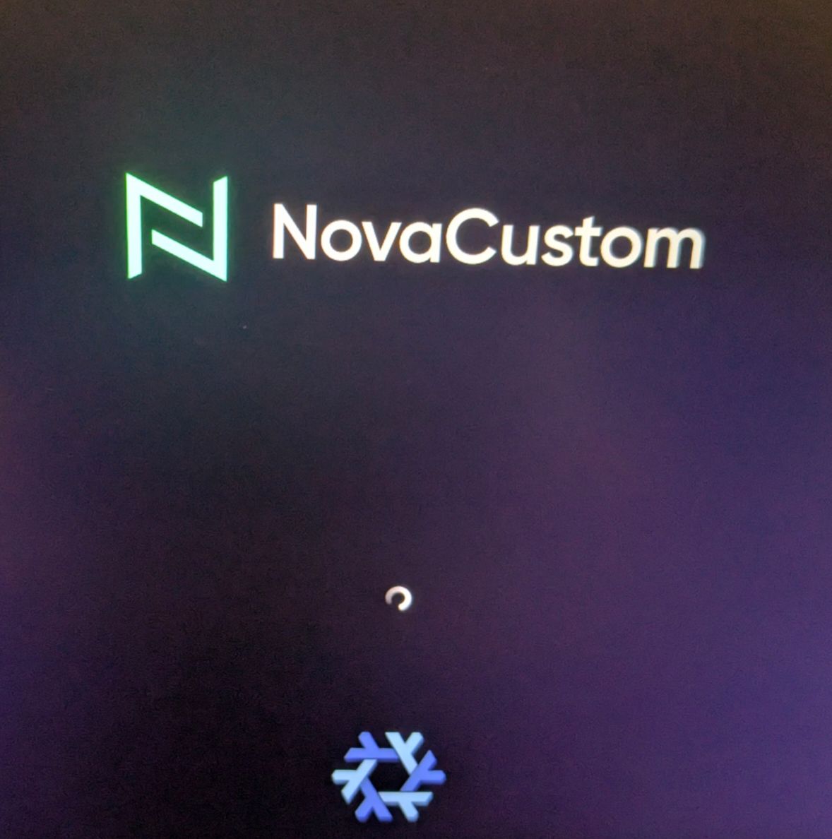

Optionally you can use a custom theme, logo, font and more.

Font and logo are optional, by default a white NixOS snowflake is used.
You can also set a custom theme, but this can be more complex. As motivation, have a look at this repo

@BoredSquirrel Thanks so much for the config! I ended up combining it with adi1090x’s Plymouth animations (as described on Plymouth - NixOS Wiki), which works nicely, except that all of a sudden I only get two tries for typing in the correct LUKS passphrase. After the entering an incorrect passphrase twice, the system either crashes and gets stuck. Has anyone else seen this?
It seems to be related to setting boot.initrd.systemd.enable = true. If false, the usual non-graphical “enter password” loop appears and works fine, though then the Plymouth theme doesn’t show up until after I’ve unlocked the LUKS volume.
EDIT: Looks like boot.initrd.systemd.enable = true is still somewhat experimental. In particular, there are still a number of tickets related to the password prompt & cryptsetup, see e.g. this board. In particular, the issue with the password prompt failing after two tries seems known.

I’m on the the latest unstable (Oct 20, 2025) and in my case it’s sufficient to enter a wrong LUKS password a single time. Then the graphical input loop crashes/aborts and the following text screen is shown:
You are in emergency mode. After logging in, type "journalctl -xb" to view
system logs, "systemctl reboot" to reboot, or "exit"
to continue bootup.
Cannot open access to console, the root account is locked.
See sulogin(8) man page for more details.
Press Enter to continue.
After pressing Return the screen is stuck for a few minutes, then the text-based password prompt appears to let you have another try. Not a particularly pleasant user experience.
Should that not occur anymore? – My nixos-config roughly matches the one from above.
That’s pretty strange. I can’t reproduce it only asking once, but in a VM it does only ask twice instead of three times… It seems systemd is trying the first password entry twice for some reason before prompting a second time for the third try. Not sure what’s going on.
Showing emergency mode at all is what I fixed. It used to just sit there on the splash screen broken. But, taking minutes to proceed from emergency mode is really weird…
