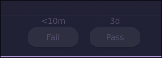

Passfail’s config does seem to be changing it just doesn’t seem to be giving any effect
yuki% cat /nix/store/lqh3ma8n3hdxvja304aglinb3vyd0j2q-anki-addon-passfail2-with-config-0.3.0-unstable-2024-10-17/share/anki/addons/passfail2/meta.json
  "config": {
    "again_button_name": "not quite",
    "good_button_name": "excellent",
    "toggle_name_textcolors": 1
yet:
You need to add
version = {
  major = 3;
  minor = 1;
after the colors part so like colors = {...}; version = {...};
You missed an “s”. It’s “toggle_names_textcolors”
IT WORKS!!!
fixing the typo and adding the version to both of the addon’s configs fixed all of the issues.
Thank you so much for your help.

            version = {
                major = 3;
                minor = 1;
minor thing. The version = stuff is specific to recolor, so passfail2 doesn’t need it.
thank you for telling me, it’s fixed.
