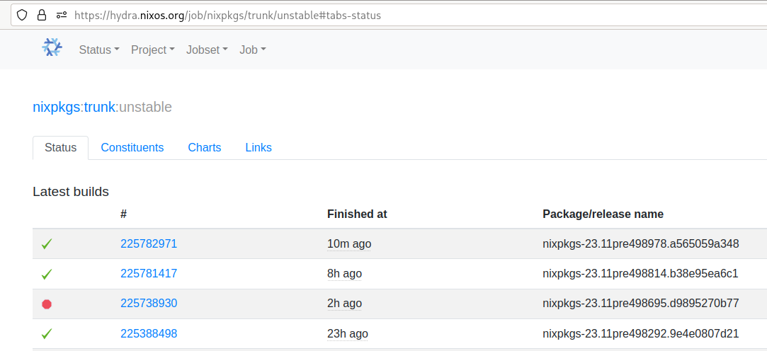

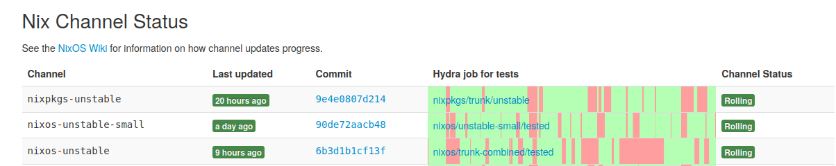

I’m looking at https://status.nixos.org/ and we can see the nixpkgs-unstable is from about 20h ago at the time of writing and is at commit 9e4e0807d214
However, if we look at the actual builds, we can see more recent builds which have passed

The a565059a348 build that is just 10 minutes ago on your screenshot, is 9h ago now. And it became the “current” nixpkgs-unstable about 6h ago according to status.nixos.org.
