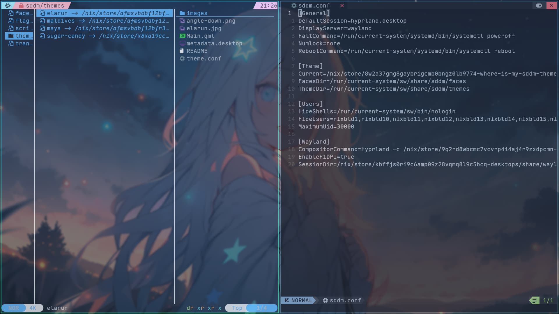

Here is where the three themes locates:
Thanks for reply, but what the config of theme is not matter. Can you set the true sddm theme?

On my system ls /run/current-system/sw/share/sddm/themes also outputs elarun maldives maya. Those three are indeed default themes link.
