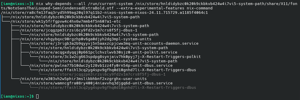

If you can find the Nix store path of the font in question, you can figure out what package is bringing it into your system with nix why-depends, like so:
$ nix why-depends --all /run/current-system /nix/store/eeeeee...eee-some-package/share/fonts/wooble.ttf

Well, the nix-find command returned this:
I can’t see anything that looks like a user application, it all looks like system stuff to me… (demonstrating my ignorance…)
system-path is just a big pile of symlinks. What is the realpath of NotoSansThaiLooped-SemiCondensedExtraBold.otf?

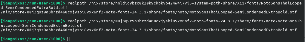

Aahhh, how would I find that? Tried a find on directory / but it only returned nix packages. :-\
realpath is a command, just type realpath /nix/store/hnldidy...-system-path/share/X11/fonts/NotoSansThaiLooped-SemiCondensedExtraBold.otf.
That means it’s in environment.systemPackages. You either added it explicitly yourself or you’re using a module that does so.
(It could also be in fonts.packages.)
This is the result. It looks like it’s in a nix package.
Okay, so it’s part of the noto-fonts package.
