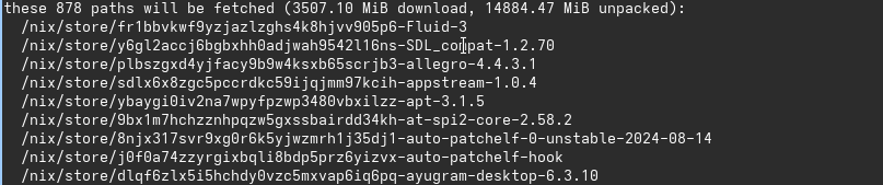

Every time I do my weekly routine (nix flake update followed by updating both the system and Home Manager), the total update size is massive. I’m talking about ~10GB of downloads and around 28GB unpacked (and yes, this size includes both the system and Home Manager updates combined)!
While investigating, I noticed that Nix is frequently downloading the exact same version of a package but with different hashes. For example, matugen-3.0.0 gets downloaded twice:

Yes, mixing unstable and stable will lead to duplicate packages. If only a single dependency is different, it’s a different package to nix even if the version number is the same.
I think @truh is off the mark here. Unstable does mean more churn, and mixing it with stable means more absolute disk space use, but it shouldn’t cause large downloads or rebuilds.
Something is going very wrong, and it’s (probably) not the multi-nixpkgs you depend on. You can test for that by just aliasing the two nixpkgs inputs into one.
You’re also using flake-parts but not even doing the one thing most people use it for (not having to type x86_64-linux once or twice). It looks like you over-engineered without understanding why you’re over-engineering.
It’s hard to spot exactly what’s going wrong because this over-engineering obfuscates what you’re doing, but this kind of thing is a huge indicator of nixpkgs repo imports being done poorly, especially in the context of NixOS (and flake-parts and flakes). Still, nix’ lazyness should save you, so all I can imagine is that somehow you made something really low-level depend on something that updates frequently through an overlay.

Thanks for the blunt feedback @TLATER, you were actually spot on about the poor repo imports and making low-level stuff depend on unstable.
I took a deep dive into my config and found exactly where the ā€œover-engineeringā€ went wrong. The fatal mistake was instantiating a completely independent pkgs-unstable = import inputs.nixpkgs-unstable {} and blindly passing it through specialArgs to over 20 different modules across my system. It was dragging two parallel universes of stdenv, glibc, and rustPlatform into my builds, inflating my system closure size to a massive 30.9 GiB and causing those 10GB weekly downloads.
