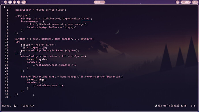

I switched to unstable branch and flickering is gone. But hyprland started to detect 2 monitors instead of 1 and there are some other annoying issues, so i’m switching back :slight_smile:
I switched to 24.05 and all issues are gone.
Thanks for help, you all :wink:
