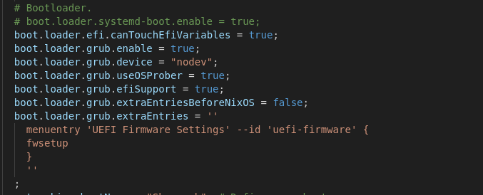

now i want to add bios entry in grub which is possible in other distros but not in nix

So first try boot.loader.grub.useOSProber = true; this should automatically detect other systems like windows on your system after a rebuild and add them to the GRUB Menu.
Uefi firmware setting is not coming and did that
So to put the extra Entries ontop or under the default entries you need to set boot.loader.grub.extraEntriesBeforeNixOS to false.
Do you mean you have an entry in your GRUB Menu to get back into your BIOS(Uefi firmware setting) and this one is not working?
Yes and I tried the entry before nix also no changees
can you post you configuration please?
try following:
  boot = {# Bootloader
    loader = {
      efi.canTouchEfiVariables = true;
      grub ={
        device = "nodev";
        efiSupport = true;
        useOSProber = true;
        extraEntries = ''
          menuentry "uefi-firmware" {
            fwsetup
          menuentry "System restart" {
           echo "System rebooting..."
           reboot
Does the System restart entry work?
So i tested this configuration too and the uefi firmware entry took me to my bios.
