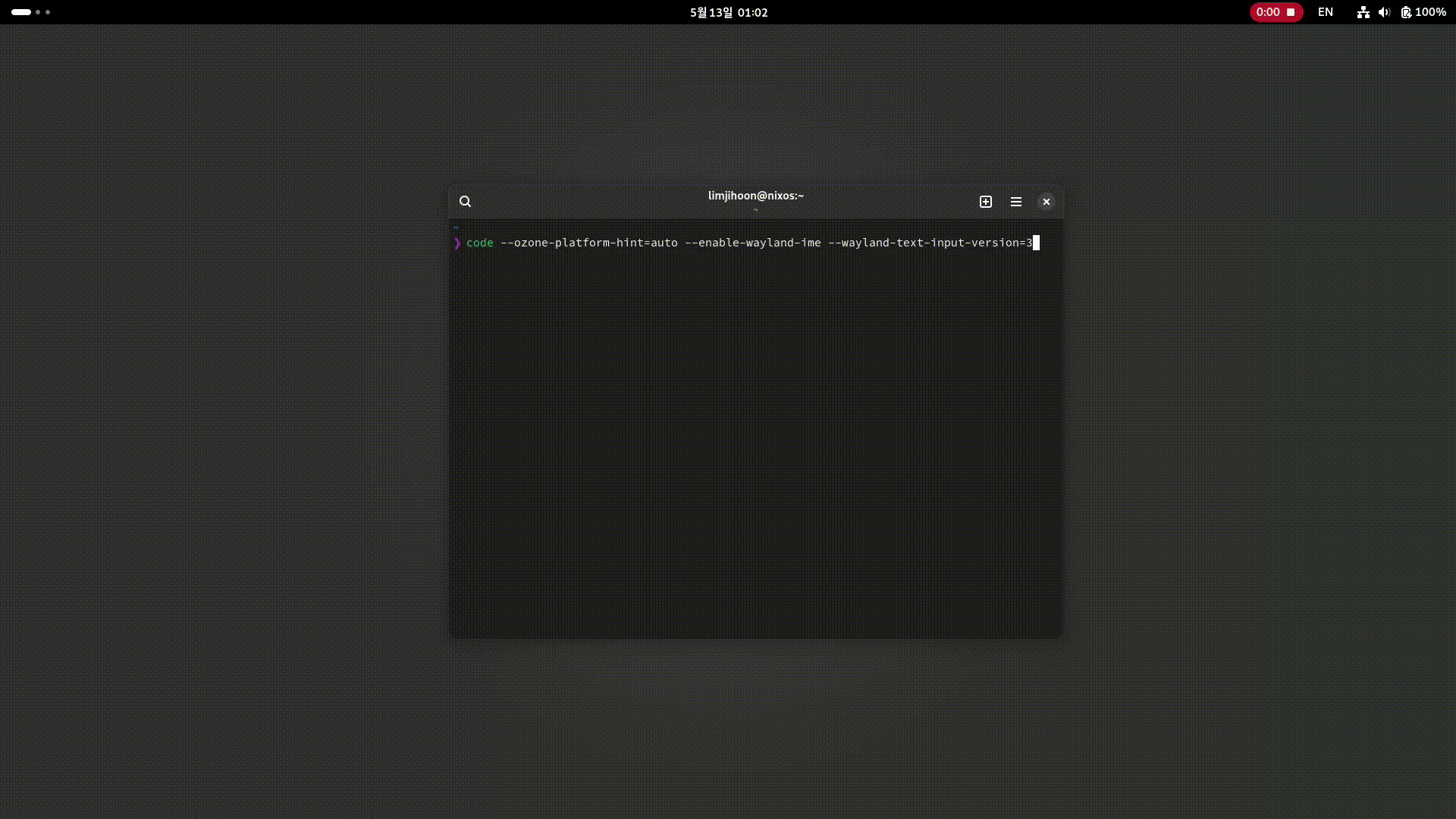

Thx It worked, but I suspect this is the just the limitation of electrons on native wayland :frowning:
Unfortunately, native Wayland support doesn’t seem seamless, as mentioned in nixos issue #394395.
I’ll look into how to configure native Wayland options for Electron apps so that they work seamlessly.
~/my-nixos main ⇡
❯ code --ozone-platform=wayland --enable-wayland-ime --wayland-text-input-version=3
Warning: 'ozone-platform-hint' is not in the list of known options, but still passed to Electron/Chromium.
Warning: 'enable-features' is not in the list of known options, but still passed to Electron/Chromium.
Warning: 'enable-wayland-ime' is not in the list of known options, but still passed to Electron/Chromium.
Warning: 'wayland-text-input-version' is not in the list of known options, but still passed to Electron/Chromium.
Screencast From 2025-05-13 01-02-13
