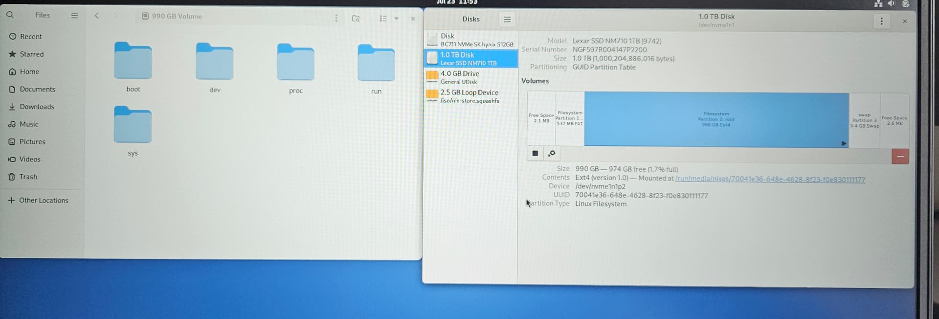

So I tried to look into files from live ISO and there are only theese empty directories inside. Also partition where windows should be is NixOS(photo below). Is there some way of restoring files
It seems the Windows partition has been re-formatted, indeed. In this case, it might be best to use a data recovery tool such as testdisk or maybe RecuperaBit.
The essential part is that you shouldn’t write anything to that drive for now until you recover your files, else this can make recovery harder.
If you can spare an external HDD that’s big enough for the partition, you can clone it as a file with dd and either have it as a backup or safely run recovery methods on it. If not, just be careful.
In all cases, I would try to recover important files first before doing anything that modifies the filesystem like attempt to reconstruct the partition.
