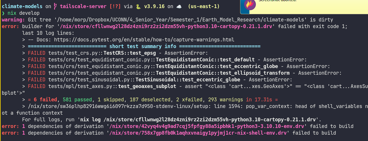

I cannot install these dependencies because [NixOS Search](cartopy package) available on nix pacakage repo is broken. After searching through github repos I adjusted the build process to fix the broken by default cartopy dependency packaged for nix. See this. These are the instructions provided to install cartopy: Installation — cartopy 0.20.0 documentation

the cartopy issue has been fixed in python3Packages.cartopy: fix failing tests with proj 9.2 by kirillrdy · Pull Request #224135 · NixOS/nixpkgs · GitHub
Thank you @kirillrdy, I appreciate all the help. The cartopy issue has been fixed.
