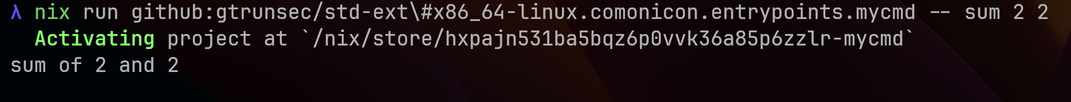

  • Python Command Interface
Use the Python library to create command-line scripting tools and through envrs to pass the values of the nix expression.
case: https://github.com/GTrunSec/std-ext/blob/44e045e3e682b7c8919129497a90d0a6c8038e5a/cells/cliche/entrypoints/default.nix#L11

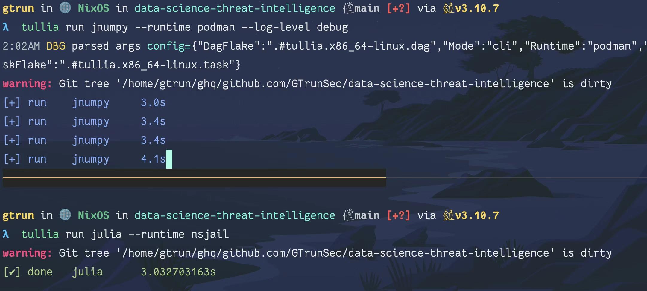

  • Dag pipeline Jobs/tasks, powered by Tullia (CI/CD solution)
Building our toolchain by a Dag runner without writing a complex bash script.
Case: scienix/nix/julia/pipelines.nix at e3d4f5fb02a504c603920d0f2480f4b0e946c30f · GTrunSec/scienix · GitHub
Case: workflow-template - 3  prefect tasks
