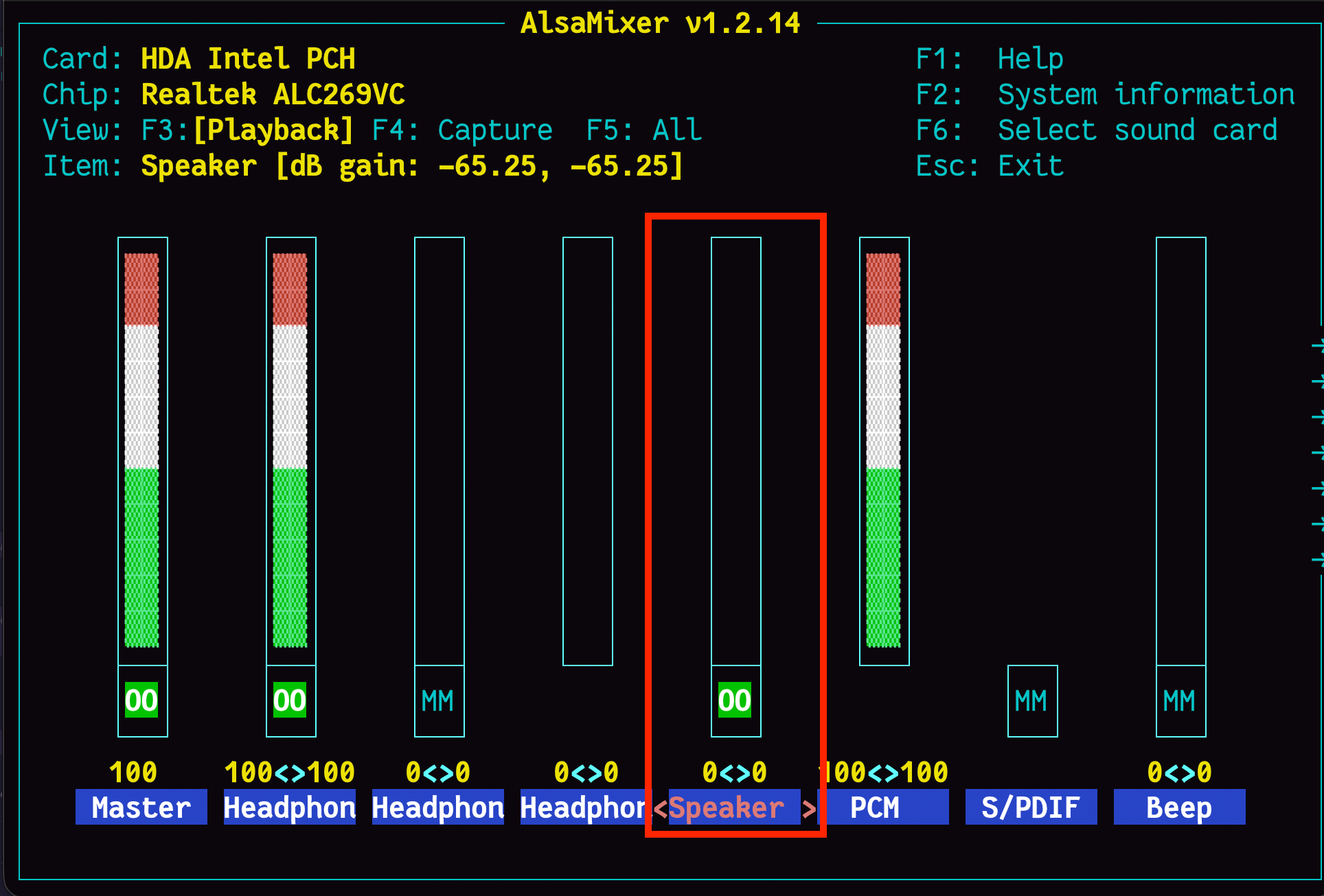

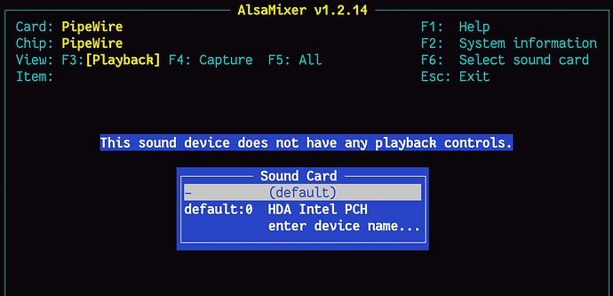

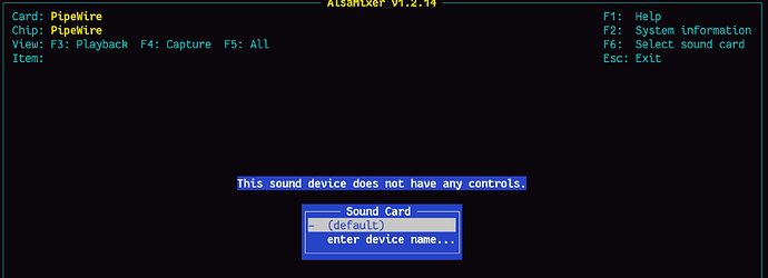

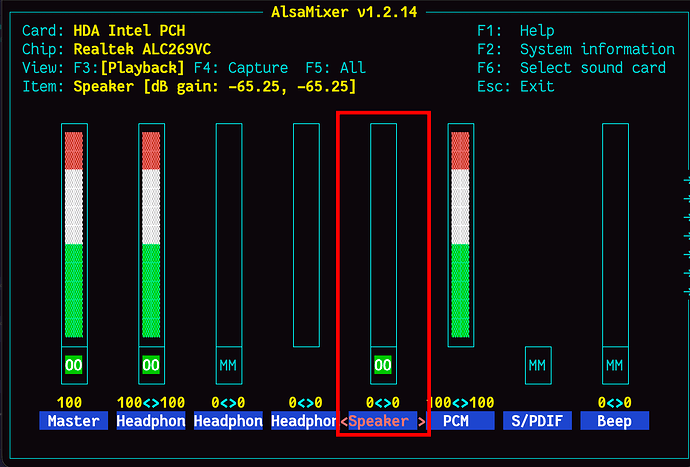

Device: Panasonic CF-SX2 LetsNote
Sound Card: HDA Intel PCH. Chip: Realtek ALC269VC
My Problem: Upon boot, laptop does not output audio. Running alsamixer shows the default sound card selected by PipeWire is - (default) (at least this is my interpretation of it; i may be wrong) and the message displayed shows This sound device does not have any playback controls.
If I go down and select the real sound card, default:0 HDA Intel PCH, I can actually see the channels. However, I then need to unmute the Speaker channel (muted by default).
Then, I need to switch the audio output device selected (seen in pavucontrol) from the default of Speakers, to Headphones (unplugged), and then sound seems to work. This behaviour seems to be noted elsewhere online for some older thinkpads at least.
My question: How could I drop this combination of settings (select default sound card, choose which channels are muted/unmuted/adjust volume, and choose defuault output profile/device in pavucontrols) into my configuration.nix, if that’s even possible?

Tried adding this as a systemd service in my configuration.nix, but doesn’t seem to work/gets overwritten (the services does successfully run and exit when checking the daemon status, but seems to be overwritten)
I suspect creating and editing asound.conf may solve this issue, but I’m a bit at a loss of where to start with it for my setup. I tried adding my default sound card 0 to my configuration.nix above as suggested, but that didn’t work, and actually removed my sound card from alsamixer:
Appreciate you all for reading through, and your time spent supporting this community and helping it grow <3
Side Note: It looks like there was a PR which documented in a bit more detail how to set the default sound card via configuration file, but this is back from 2020 and I couldn’t seem to get it to work. It also was introducing Wireplumber and Jack into the mix, and its relevance/necessity was unclear, as if there’s a way to select the default sound card + muted/unmuted channels within configuration.nix itself, that would be endlessly cleaner.
