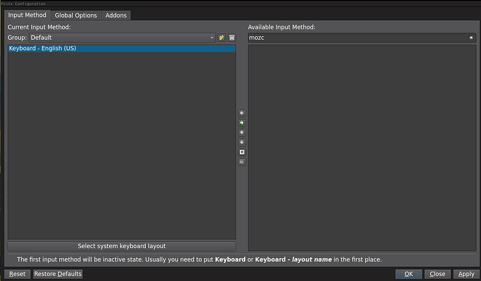

I’m dealing with a similar issue (mozc isn’t showing despite having it in my config here). Any ideas on why this might be the case?
I tried restarted and everything above, but nothing seemed to help.
Hey two things that tripped me up the first time I tried this:
  1. When you open the config tool, you have to check/uncheck a box to show all the languages. For me it was disabled by default.
  2. You don’t search for “Japanese” in the language list; you search for “mozc”.
Still no beans (this include the checkbox being unchecked)
Just to be extra sure and because I don’t see it on your screenshot, did you uncheck this box?
If all else fails, I’ve heard people have had success with ibus. :sweat_smile:
Guess I’m going to ibus
Thanks for the help regardless lol
