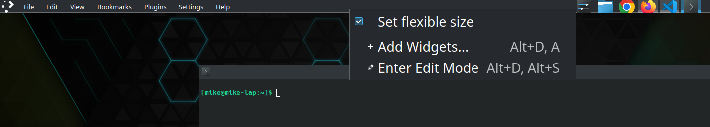

Now the screen tearing is gone, but the fonts and icons in KDE are now humongous on the task bar, window decorations, and context menus.
I’m pretty new to Linux and don’t even know where to look to attempt to resolve this. I tried changing the desktop theme, font sizes, etc. in KDE but that had no effect.
I’m hoping that someone can point me in the right direction. I have prime.sync.enable = true because I had all kinds of problems with offload.
