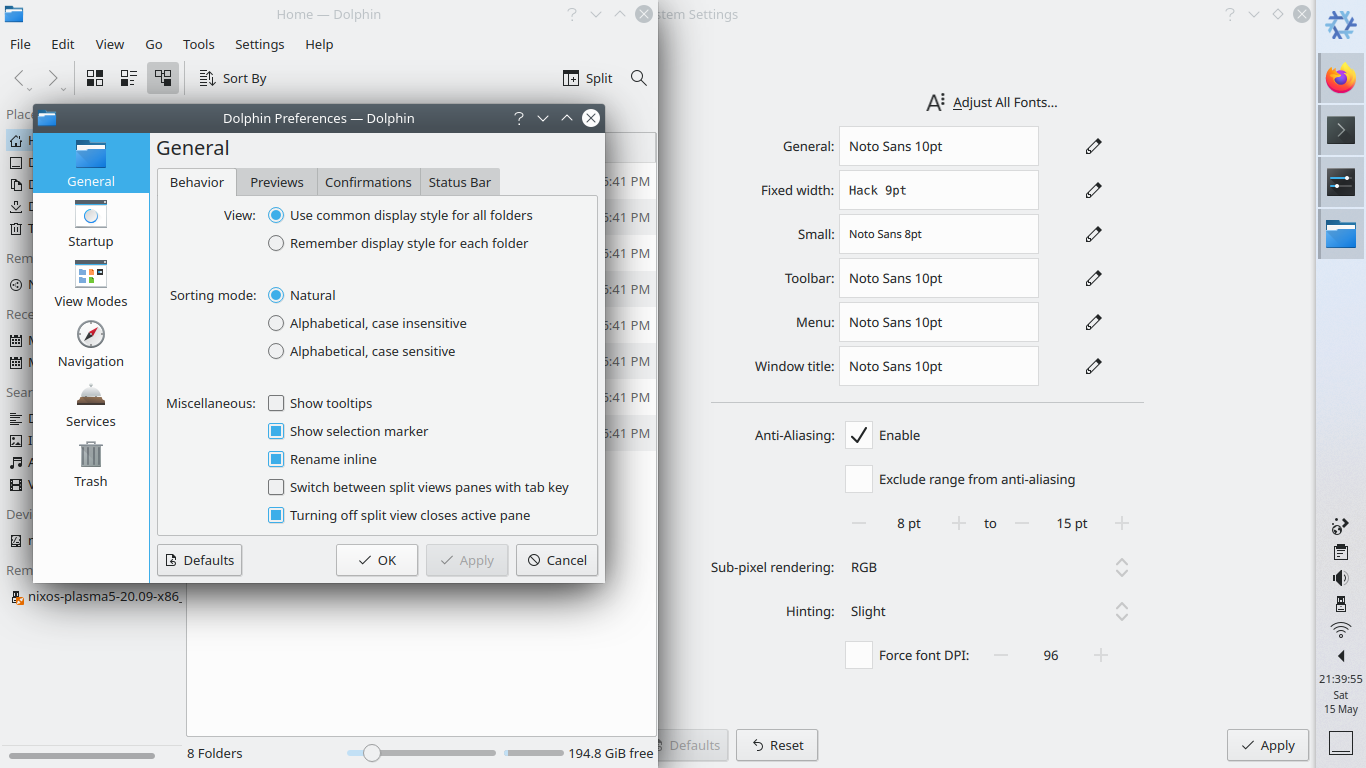

Hello. Parts of KDE theme looks off in a freshly installed NixOS:
The widgets in the window on the left-hand side looks fine, but the widgets in the window (System Settings) on the right-hand side look very off.
I would appreciate any help here.

Hello and welcome!
This is a bug that affects stable 20.09, I assume this is what you are running? It is fixed in the upcoming NixOS release:
Hmm. I did suspect that some QML components weren’t reading the theme right. Thank you for the pointer. I will wait for the end-of-may? Nixos release.

You can probably fix it on 20.09 if you want.
qqc2-desktop-style is in environment.systemPackages.QT_QUICK_CONTROLS_STYLE either needs to be unset or set to org.kde.desktop (the Plasma bit in the linked issue is incorrect.If qqc2-desktop-style is already in your global env, you don’t need to rebuild - just fiddle with the variable in a terminal and launch systemsettings5 from there.
