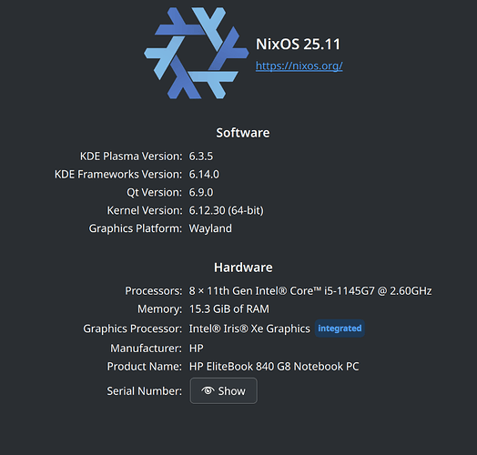

Kernel Panic after a fresh install
It happened more then 20 times in past few days. Every think would hang with a blinking capslock. All i did was copy the config to new system and flake update. I tried to read the pstore dmesg.txt but I cannot figure out what is the issue.
llm says its a case of Control-flow Enforcement Technology (CET) Violation and also that This appears to be a compatibility issue between:
  1. Your CPU hardware with CET capabilities (Intel 11th Gen Tiger Lake)
  2. The kernel’s CET enforcement mechanism
  3. The nf_tables module that wasn’t properly compiled with CET support
The most likely causes are:
  1. A kernel module that wasn’t built with the same CET settings as the main kernel
  2. A bug in the module’s compilation process
  3. A CET-related configuration issue in your kerne
Fix : boot.kernelParams = [ “clearcpuid=ibt” ]; boot.blacklistedKernelModules = [ “nf_tables” ];
I donot know how valid that response is. Can any one help me out

here is my system info
so should i add
boot.blacklistedKernelModules = [ “nf_tables” ]; and hardware.enableRedistributableFirmware = true;
to hardwareconfigureation.nix? is it safe? I just donot want to be locked at boot cz i surely donot have expertise to handle that kind of scenario
