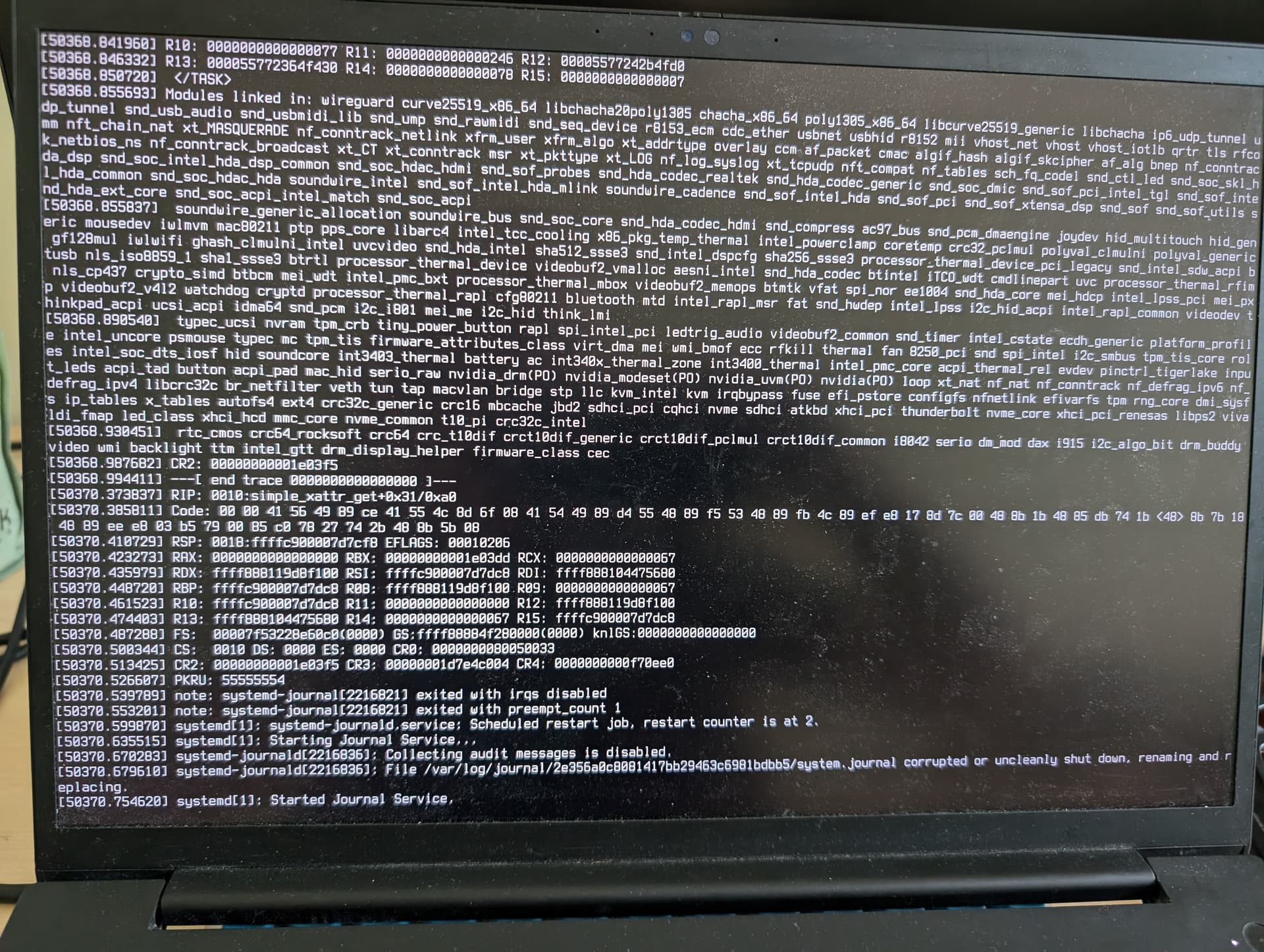

Since upgrading to NixOS 24.05, I regularly get kernel panics (System frozen, Caps Lock LED light blinking). Since the cause did not get logged, I enabled crashDump:
  boot.crashDump.enable = true;
Yet, I am still not sure where to get the logs.
‘Luckily’, sometimes the system crashes when I switch to tty1, so I get to see the kernel error messages (see picture attached). Could someone help me parse them? The folder mentioned in the screenshot-picture (/var/log/journal/2e356a0c8081417bb29463c6981bdbb5) is full of *.journal files.
Any help would be greatly appreciated!

Kdeconnect does segfault, but it really should not bring the kernel with it, thats a kernel bug.
Note that what is shown (but snipped?) here is a kernel Oops, not a panic. The system should continue to function although what triggered the Oops may also have triggered a panic shortly after.
I also don’t think this has anything to do with KDE connect. Its segfault happened 15s before the Oops.
The kernel claims that its tainted with an externally-built proprietary module. Do you use the Nvidia module?
I’d consider it the cause until proven otherwise.

You should try to reproduce the issue without the module; removing any taint. Nouveau+NVK should be usable these days.
Another thing I notice is that the WiFi has deauthed right before the panic/oops twice now. Which card and driver is it? Can you repro this with the rfkill engaged?
Do the panics really not contain a call trace? Because all the one’s I’ve seen so far do and it contains the most useful information.
possible related to Series 550 freezes laptop - #18 by patrick4242 - Linux - NVIDIA Developer Forums ?
switching to open kernel seems to fix the issue

This suggests to me that the issue might lie in the VFS or kernfs (i.e. /sys/) code. It might also be a red herring though.
Is this the oops trace or the panic trace? The panic would be more interesting.
Is it always the same call trace? Collect a few and compare.
This is just for troubleshooting. If you cannot reproduce the issue without the Nvidia module, only Nvidia can help you and you’d have to take it to them.
Okay so it’s a relatively recent Intel card. They should be okay but I heard they’ve gotten a bit shoddy in recent years.
It disables wireless (radio frequency) devices such as WiFi. See man rfkill.
I’ll keep an eye on it and report back! So far no crashes with the open driver, although the suspend not has some issues (potentially this problem)
