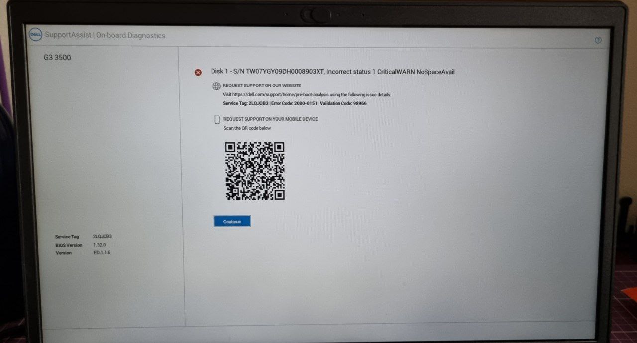

Damn it, I updated all firmwares with fwupdmgr and now I also have a boot time error:
But still, the laptop boots…
Downgraded the firmware of my NVMe and the boot issue is gone…
