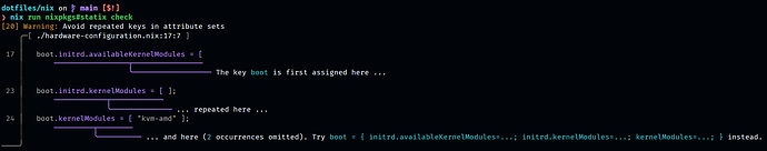

When I started using statix in my code editor, at first I though that repeated_keys warning is useful. But when I went to my nixos config and tried to fix these warnings, I quickly realized, that I actually prefer repeated keys.

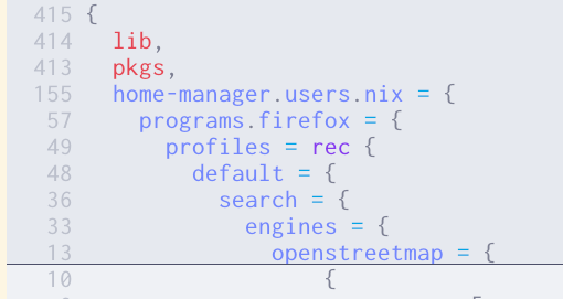

  • I’m using treesitter-context in neovim. Here’s an example of how it looks like:
    If I were to enforce grouped keys, this would result in home-manager.users.nix being split into 3 separate lines, and programs.firefox into 2 separate lines. This would waste vertical space in my editor. Though, that’s a bit specific problem, it’s not a problem in vscode where breadcrumbs are always in single line.
