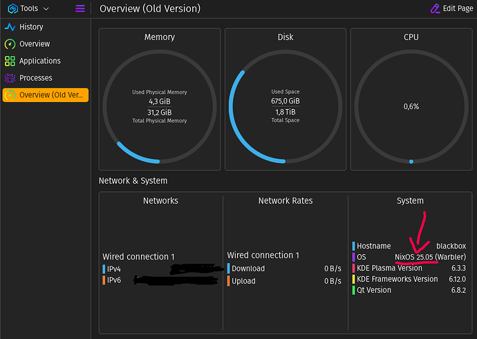

Interestingly, system monitor tells me that I have Qt version 6.8.2 and KDE Plasma Version 6.3.3. and KDE Frameworks Version 6.12.0.

Update 2
After booting, I have a nixos 25.05. After doas nixos-rebuild switch --flake . I have a nixos 25.11. I have absolutely no idea why this isn’t persistent, and why it’s wrong after the next booting. the hell.

This is probably a red herring. I mean, it’s not surprising, you’re using nixpkgs-unstable: flake.nix · main · jules / juless-nixos-config · GitLab
Unstable’s version number will tell you the version of the next stable version, because that’s what’s in development. You likely just never updated your flake.lock before (deleting and rebuilding will make nix recreate it from scratch, with the most recent commits for all inputs), or previously had a stable nixpkgs in there.
