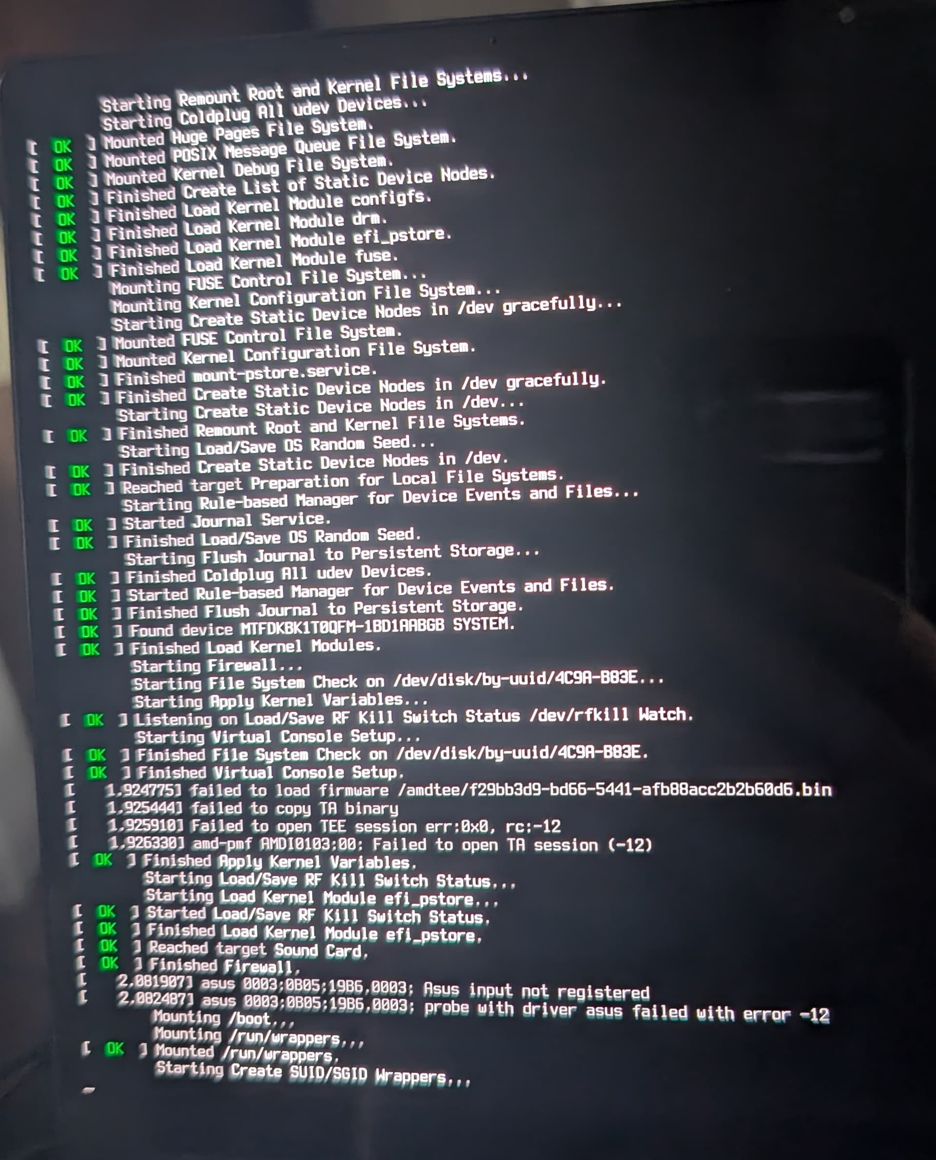

I figured this was maybe due to the linux-firmware nixos package not being new enough. So then I tried this:
hardware.firmware = [ (import <nixos-unstable> {}).linux-firmware ];
But this causes a hang on boot complaining about the firmware (see photo).
