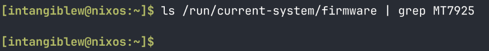

Missing MediaTek firmware!
I have hardware.firmware = [ pkgs.linux-firmware ]; in my system configuration.
However, I checked /run/current-system/firmware, and didn’t find firmware related to MT7925. As it supposed to be here accroding to Linux firmware git repository.
I use nixos-unstable repo by the way, and the rev: 0b4defa2584313f3b781240b29d61f6f9f7e0df3

(2) Using ls and grep to find files may have led you to the wrong conclusion. The firmware files will (most likely) be in subfolders, so your ls would not be seeing the filenames with MT7925 (case-sensitive). You might want to check that using find /run/current-system/firmware -iname '*mt7925*' instead.

There aren’t subfolders with mt7925 firmware in that diretory. While it contains a few other MediaTek device firmware:

Does the directory /run/current-system/firmware/mediatek/mt7925/ not exist for you? It exists for me on nixos 25.05 and has files like BT_RAM_CODE_MT7925_1_1_hdr.bin.zst (matching what’s in mediatek/mt7925 · main · kernel-firmware / Linux Firmware · GitLab).
It even does not have mediatek directory.
Have you installed linux-firmware?
Yeah, have you? Does nix-store -qR /run/current-system | grep linux-firmware show anything? For me it outputs /nix/store/103ckyl3blv252b01ymaq36hfmdy73n6-linux-firmware-20251011-zstd and the directory /nix/store/103ckyl3blv252b01ymaq36hfmdy73n6-linux-firmware-20251011-zstd/lib/firmware/mediatek/mt7925 also exists with the same files as before. If that command doesn’t output anything then your current system doesn’t include linux-firmware.
Oddly enough, mt7601u.bin.zst that they gave as an example would also be coming from linux-firmware.
Allright, sorry for my hasty assertion, there IS a /run/current-system/firmware/mediatek/mt7925/ directory on my system. And I see .zst suffix firmware in that directory.
BT_RAM_CODE_MT7925_1_1_hdr.bin.zst  WIFI_MT7925_PATCH_MCU_1_1_hdr.bin.zst  WIFI_RAM_CODE_MT7925_1_1.bin.zst
